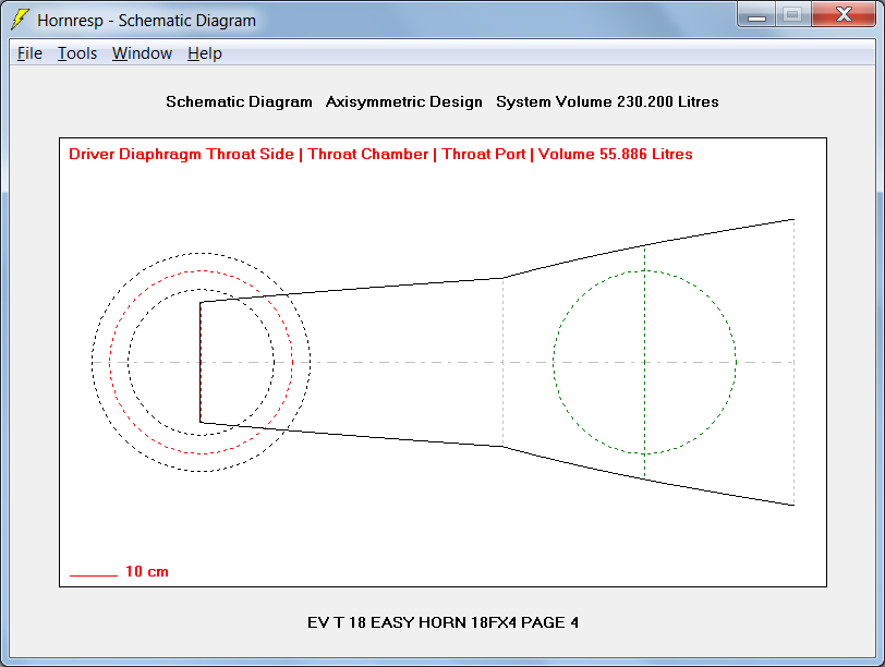

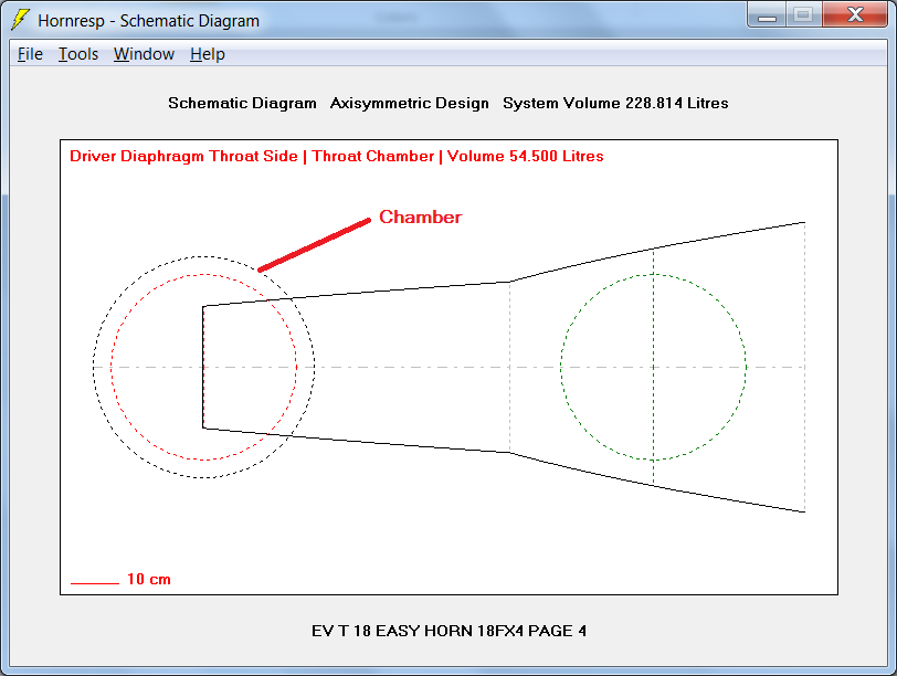

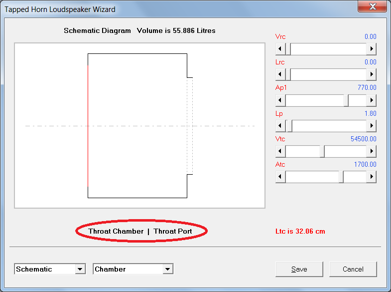

I want to know where is my mistake in thew input ?
The rear chamber is not seen in the schematics.
Hi palesha,
You haven't made a mistake, the "rear chamber" (for a tapped horn, specified using the throat chamber parameters, as you have done) is indicated in the schematic diagram by a black dashed-line circle. Atc =1700 cm^2 so the chamber radius is 23.26 cm, which is 3.76 cm larger than the diaphragm radius of 19.50 cm, as shown in the attachment.
The only time that the chamber line will not be seen is when Atc = Sd, but moving the mousepointer over the red diaphragm circle will confirm (by way of the associated message) that the specified chamber is still actually there.
Kind regards,
David
