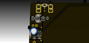

Here is an image of the power supply/soft start and Mosfet speaker switch. Still working on controller card.

Is this a separate power supply for the relays and protection circuit?
The boards take up quite a lot of space. My problem is available space in the casings.
I have one case with all the amps and attenuator power supplies and another case with the filter, attenuator and amplifiers. Both cases are full so my next build will have to have larger cases.
I thought about trying surface mount components for the protection circuit but might have problems with the filter capacitors.
Did you make the boards yourself?
Yes, it powers the controller board and speaker switch.
I made this separate board design, so P/S can mount by Amp power supply, controller can be away from P/S and speaker switch mounts on binding post. All the boards can be installed in separate box for external protection on existing Amps.
No, ordered from PCBway.

Soft start options
I finished one of my power supply/soft-start boards. I have R1 pads for leads running to terminal board to the side, so I can use inrush limiter or power resistor, if it fails badly, won't burn the board. Will build speaker switch next. Still need to finish MCU design and software.

Let me guess you use a toaster oven to mount the Mosfets. Interesting circuit, my setup will watch DC offset, sink temperature and bias. I'm pretty much stuck on this coarse having bought everything but the controller PCB board. Here is the speaker switch, I just finished.
