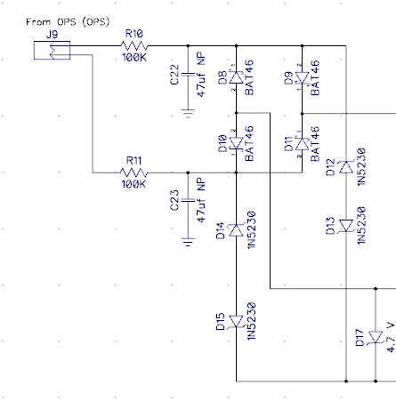

I have now tested circuit on breadboard with led indicators at relays. led's were always on to start with so I connected 500k resistors from opamp inputs to earth as these were floating. Had to change reference voltage at opamps to give 0.25v and -0.25v.
This sets sensing dc voltage at approx 0.7v and circuit works fine.
I updated spice circuit and tested inputs at 2hz which I understand is lowest frequency on a CD recording. Works okay between 0 and 0.6v dc input but at around 0.7v dc the relay output oscillates ON/OFF at 2hz.
Its the sine wave residue after the two pole filter interacting with the opamp comparator. Above 0.8vdc the relay output is stable.
I am sure this would happen on any low pass filter sensing system when the transistors turn on and off. With a single pole filter the oscillation covers a larger range so I don't understand why some articles say a two pole filter is not so good as a single pole.
In practice I would think that at failure the dc offset would be the supply rail voltage so I will be building this circuit in a separate case.

DC Detect
oldjack,
The problem with anyone's design for DC protection is compromise. Use more than a single pole and the charge time (i.e. detect time) goes up. Use any diode or bridge, you are counting on forward leakage for DC levels, without them you have whole new problems. You need a resistor on the input, more than likely + side, opamp/comparator to control input bias, which then changes the trip level. There are other design issues. Any design that will disconnect the speakers when something bad happens is a good thing to have.
MI
PS I redesigned my DC Detector again. I believe this will be the one.
oldjack,
MI

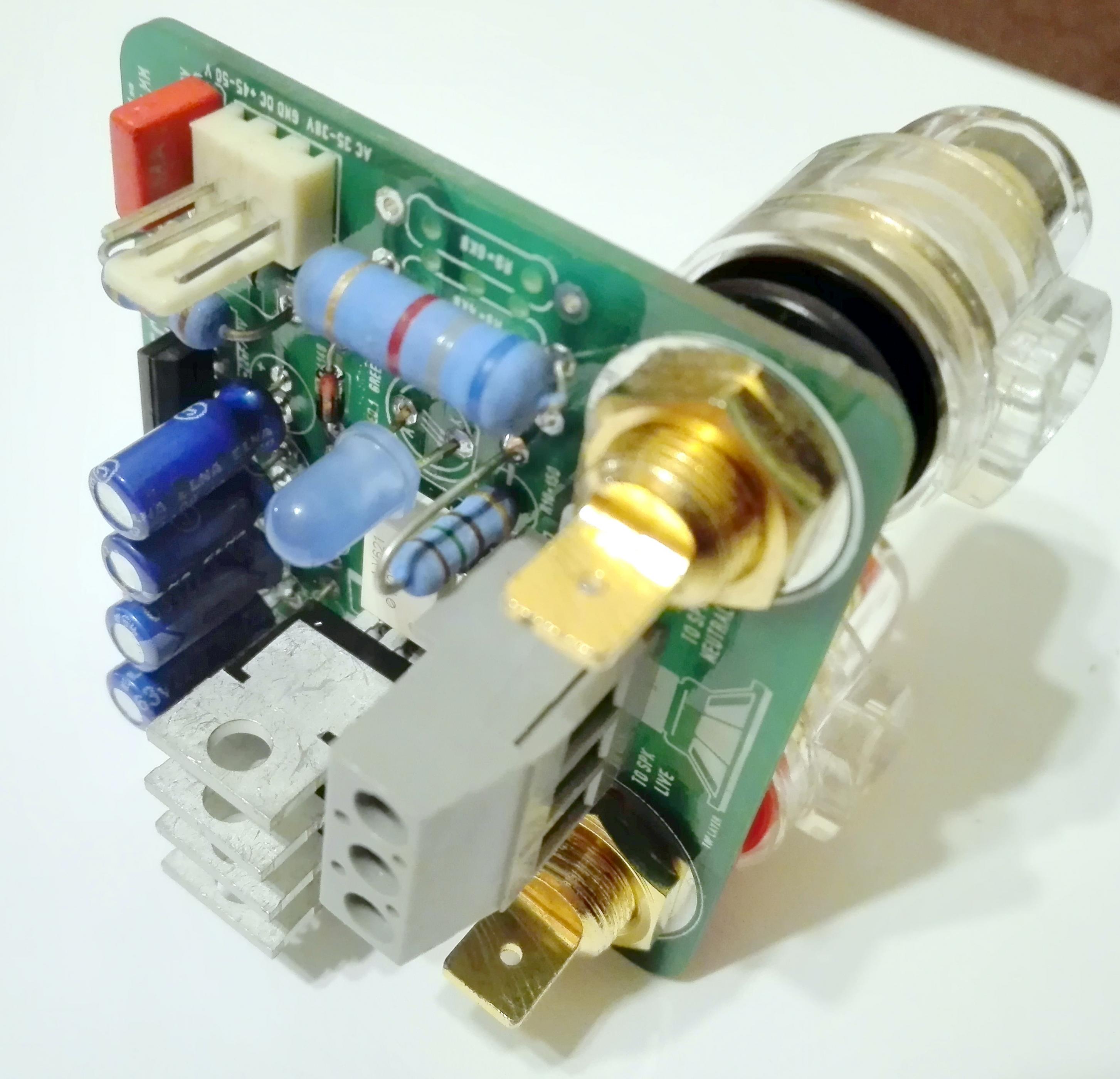

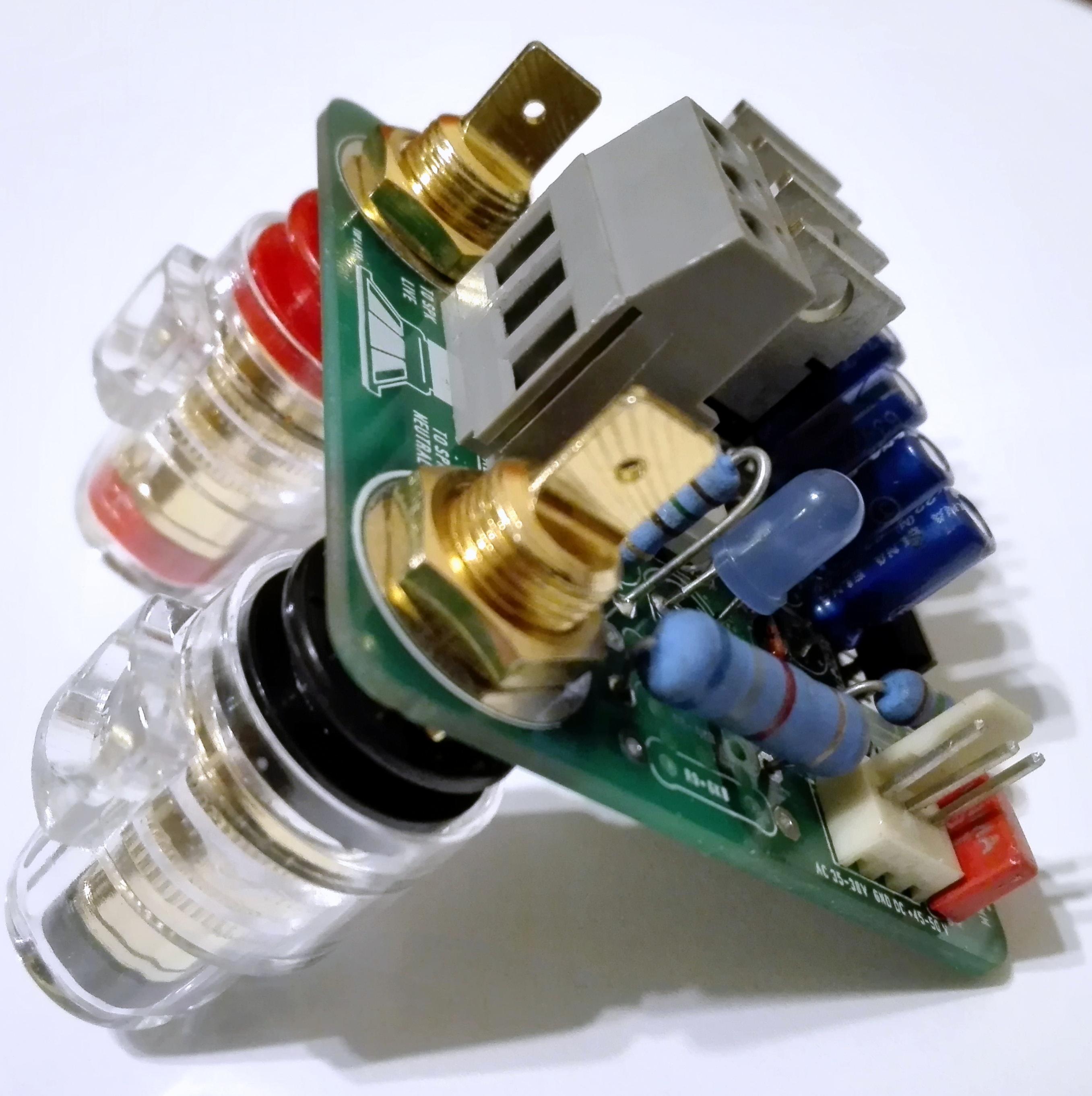

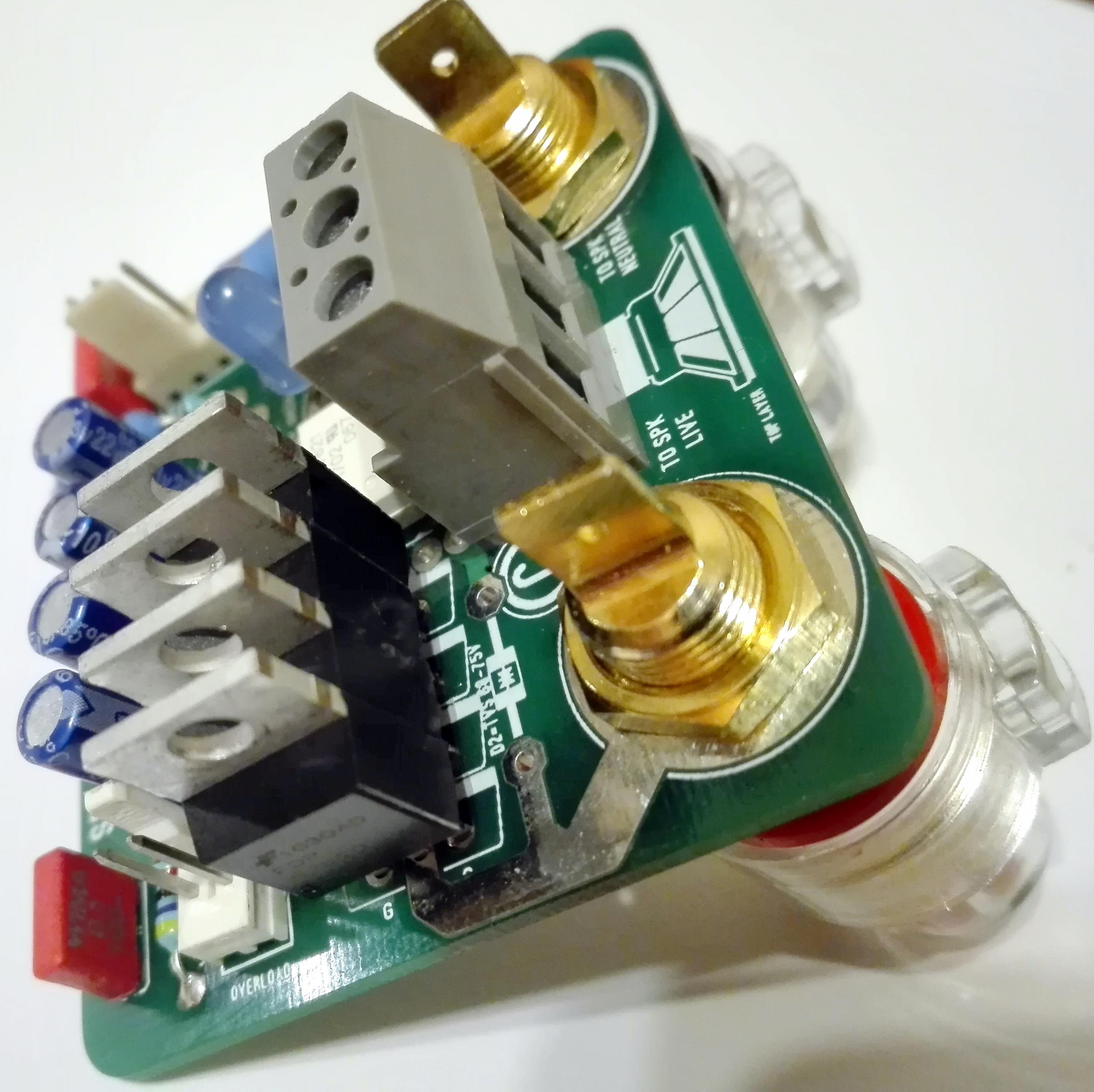

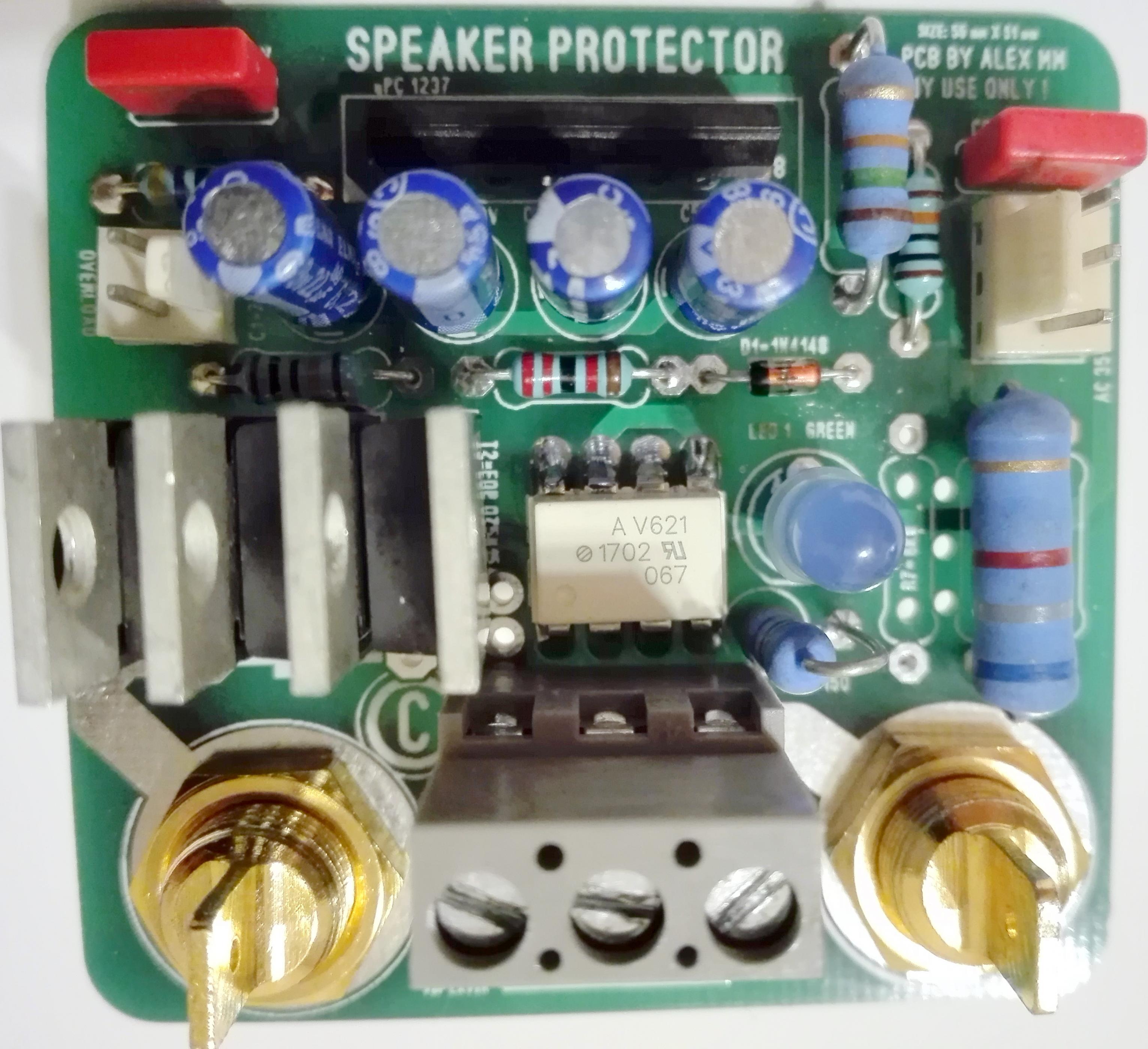

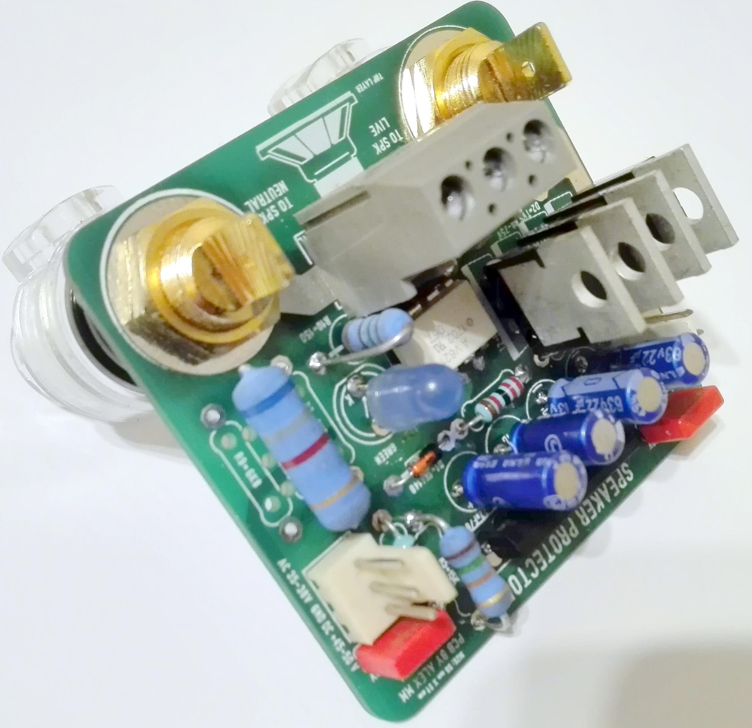

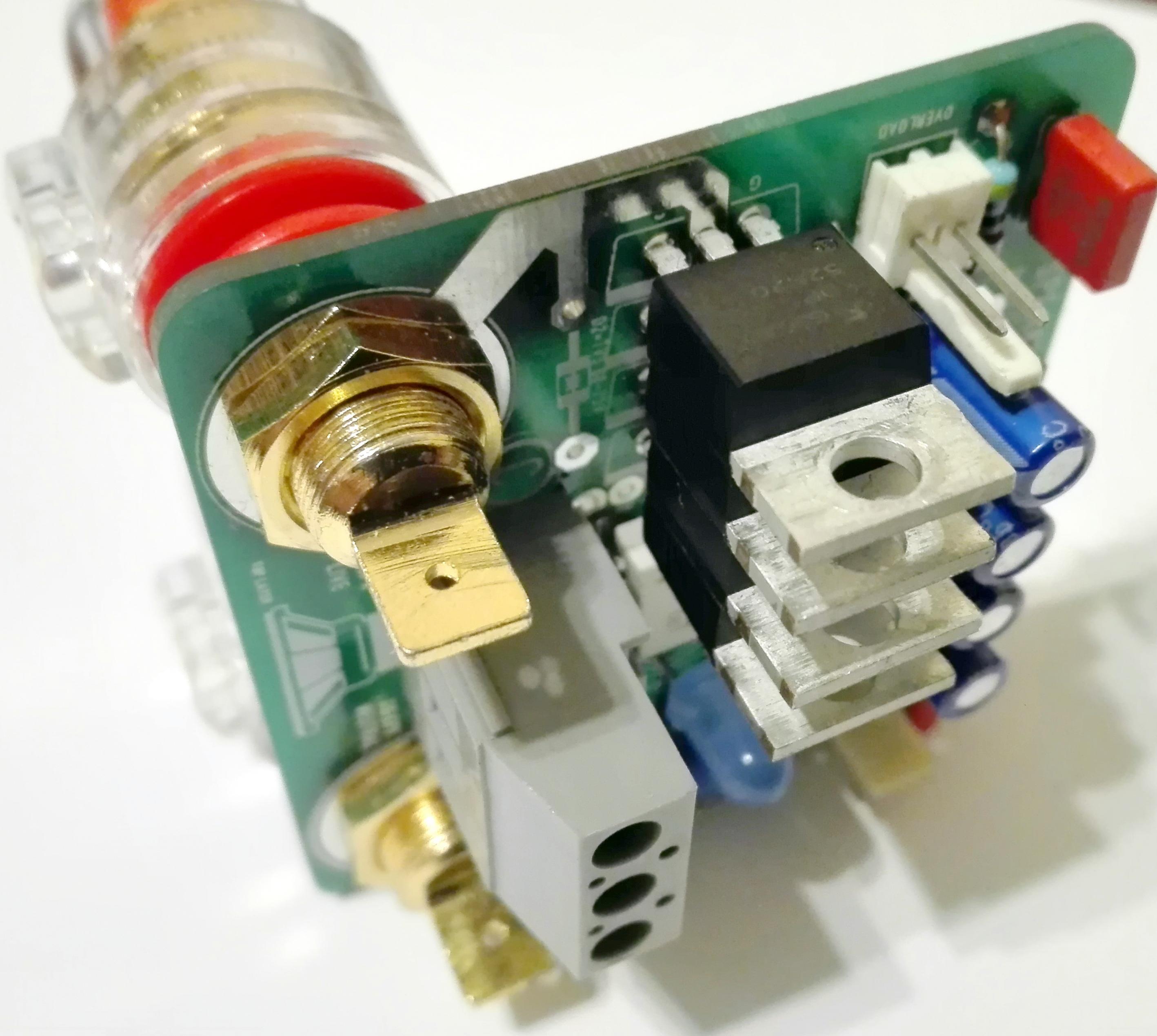

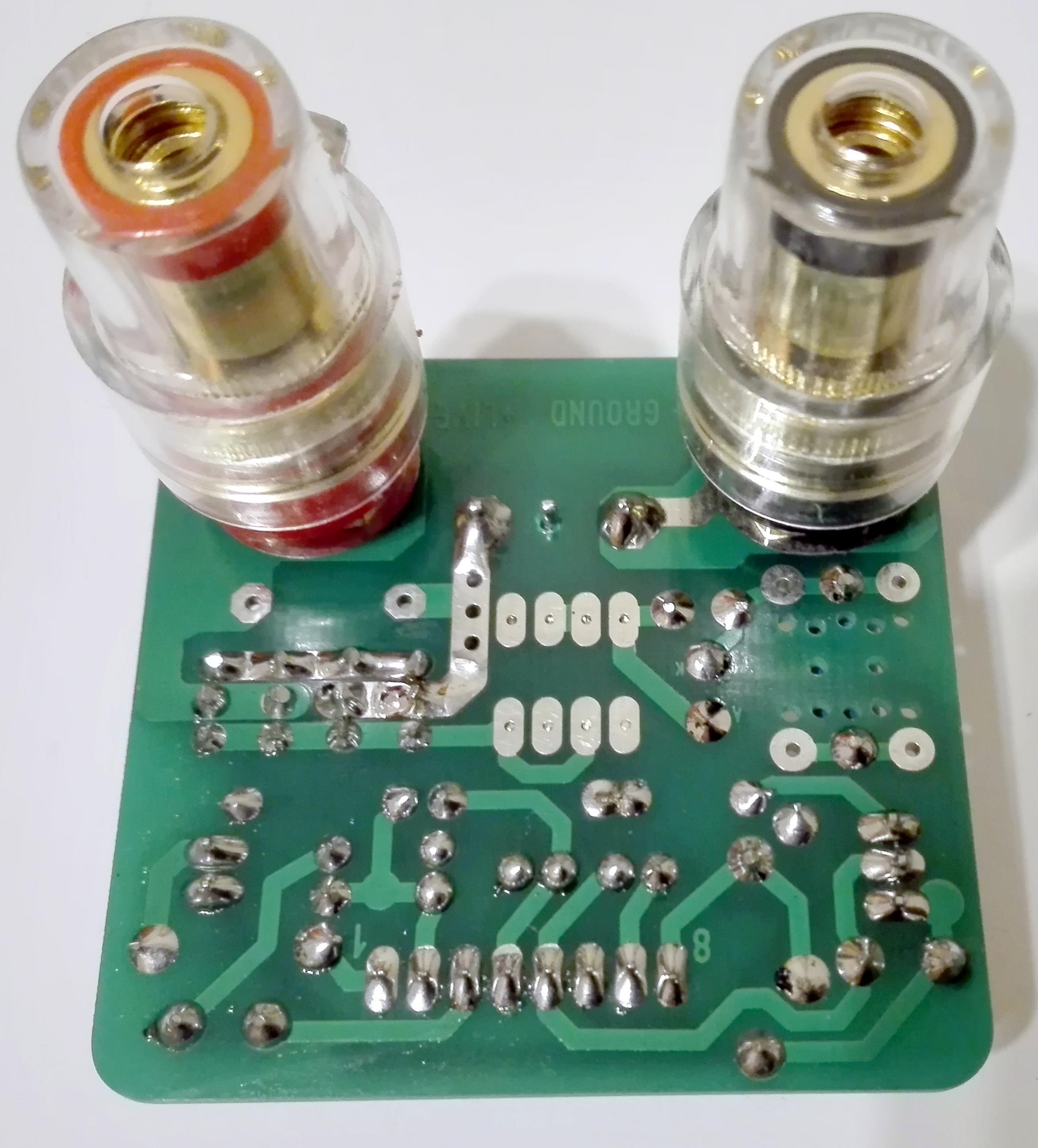

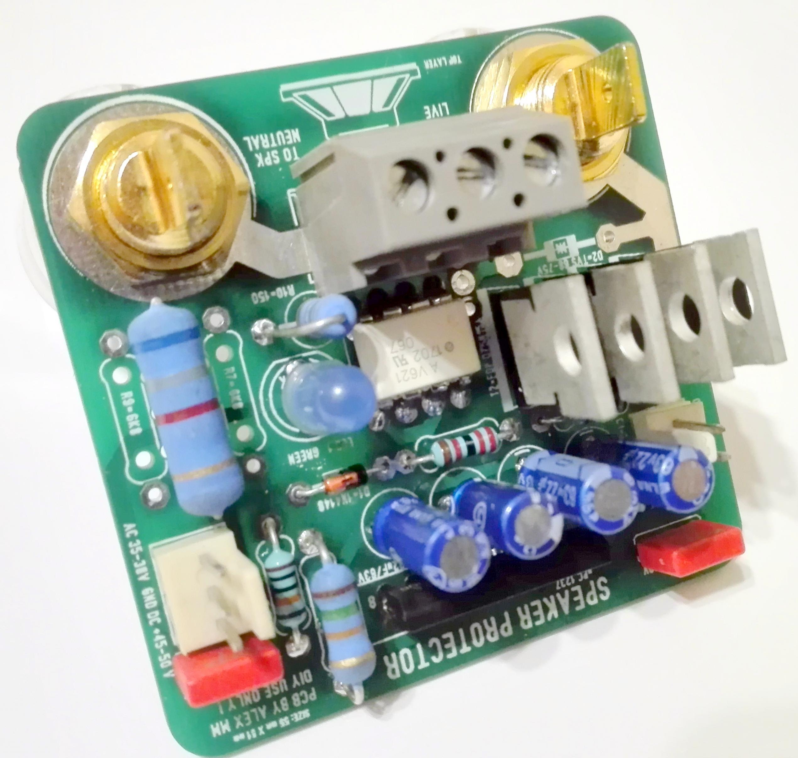

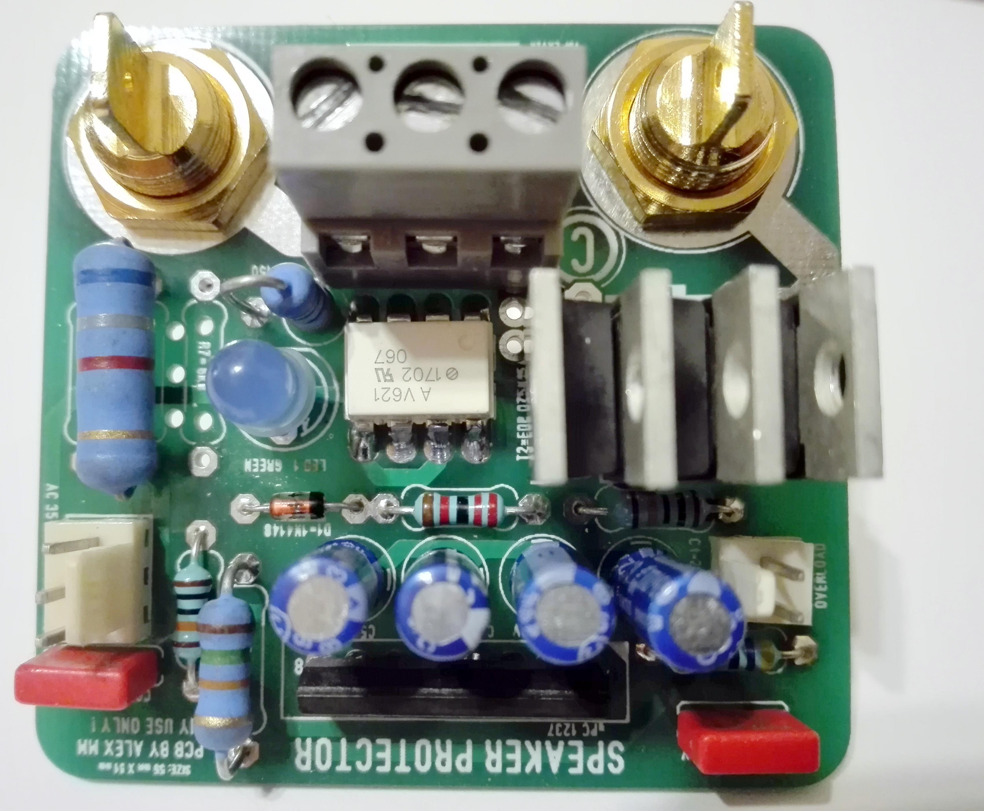

My speaker protector use old specialized IC uPC 1237 HA combined with ASSR 621 and power MOSFET .

Yes the delay time does increase using a 2 pole filter, I could see the delay on the test circuit between the dc voltage input and the led's operating. It was probably near 1 sec.

I will test the circuit again using a single pole filter; I think when I simulate using spice it probably does not reflect what actually happens in practice.

The problem with opamps in open loop is numerous, latch-up, unpredictable outcomes, input bias, etc. Comparators run open loop which makes them faster, but the problem I don't like is they're open collector/drain, unless you want to spend a lot more, so I have to deal with the -5 to +5 v output to my MCU. Your LT1001 has high open loop it should be just as fast. Run your simulation and look at DC levels at C2 and C3 with just 5 vDC and then 50 vDC watch how long each takes to get to over 800mv your trip point.

Your point of view it's correct , got it I have 10 pieces from UTsource and I will test soon ! Thanks for comments .
