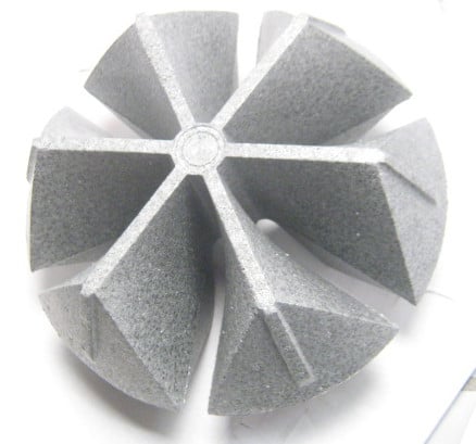

about the manifold, or mannifold may i say
8cm thick easily fileable mdf
drill holes to angle where path lenght match
this radial type interests me too

Now thing started to move on. modeling clay to get easy 100% custom shape.
some measurements for reference before clay, i hope i can keep my microphone setup untouched so measurements are comparable.
mouth is too large, maybe over 70cm2, i wanted it to be 50cm2
and path from cone to mouth is uneven
just wasted couple of hours of my life again.
path from voicecoil and outer went uneven.
well i have to check it out again from scratch
