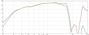

I made some crude simple measurements of my ROAR12 today. I have just started playing with REW and my Umik. I got the microphone yesterday, so I have not had time to learn much yet. Please excuse any noob-mistakes, of which I am sure there are plenty...
The driver (B&C 12PS100) is brand new. I have been plying some low level music through it for an hour or two. Once the suspensions are soften by use, the low end of the passband will increase in level. The suspension feels rock hard at the moment.
It is a simple large duct attached to the front of a THAM15. 4 pieces of plywood held together with hinges in the four corners. All attached somehow to the front of the THAM.
Or you could build the large duct/front resonator as a large box with one side open and a large cutout on the other side of the "box". This way it would be easy to transport the THAM15 inside the duct, and just mount the duct onto the front of the THAM15 when you are rigging the soundsystem.
Johannes
(These measurements are made with a raw driver and does not portray the real ROAR12 response.)
Here are two better measurements.
In the spl-response I show the raw response of the ROAR12 (red trace) with the new and raw driver, which needs several hours of 500 watts program power to loosen up.
The green trace shows the response with a 48 dB/octave 30 Hz HP and 48 dB/octave 180 Hz LP filters. All the filtering implemented with a MiniDSP 2X4HD.
Even though there is a 13.6 ms hump at 168 Hz I would not hesitate to use this ROAR12 up to 180 Hz.
The group delay graph shows the same with or without steep crossover bandpass-filtering typically used in live pro use.
