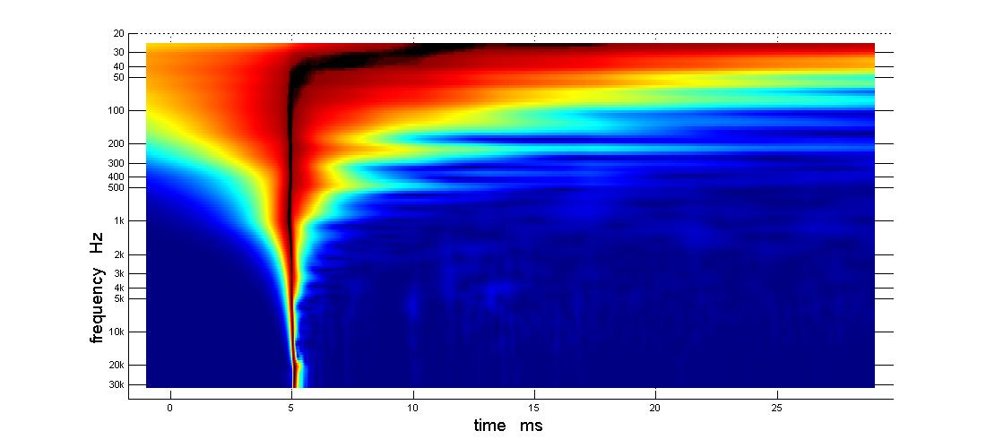

I also did a trial run using paragraphic phase eq to cover the entire spectrum
tda3d
tda pl
REW fr suggests I did something wrong at 22 and 35 hz
finally a step function that is somewhat presentable

Looking at TDA with wider time limits, I see the output below 45 Hz out around 60 ms. pushed out there by a room resonance...
The min phase in REW is indescribable so I'll show you a picture. Phase goes from 0 at LF to 1800 degrees at that peak with 12 or 13 wraps when drawn that way.
REW is doing 48000 samples/sec. TDA is 96000
Here is the IR. I've always had an early reflection just under 1 ms and also always had what I thought was ringing in that region. (See earlier IRs)

It looks like the bend in the direct response of the TDA graph is up in the breakup region of the CD's diaphragm. In the FR, there is a peak at/about 18 Khz and then the response drops quickly
What I wanted to see is if the ringing in the impulse was showing in the waterfall plot. It was...
Here's the early waterfall plot:
And after some EQ:
I stopped where the tweeter hands over to the mid. I still think there's some possible gain left in that crossover.
What does that do for the ringing in the impulse?
Before:
After:
Now before we can conclude this can be EQ-ed away, we'd have to do some polar measurements to see if this holds up over a wider angle.
It could be the midrange taps that cause the rough response.

Instructive. This reminds me that the IR tells the entire story but also that I don't know how to read it in the IR.
I'll note in passing that the paragraphic phase EQ IR has less ringing, supporting the hypothesis that at least some of the ringing can be EQed away
But if that is ALL ringing, then where are the expected early floor reflections? I did throw some padding on the floor for this measurement but I didn't think it would suppress the floor completely.
Now I can see what you mean by early waterfall. I set the waterfall time range to 3.6 ms but got a totally different picture viewed from a different angle. you must have different windowing than I was using and different waterfall controls, except the IR windows don't seem to affect the waterfall. Can you tell me the rew settings for reproducing these early waterfalls?
