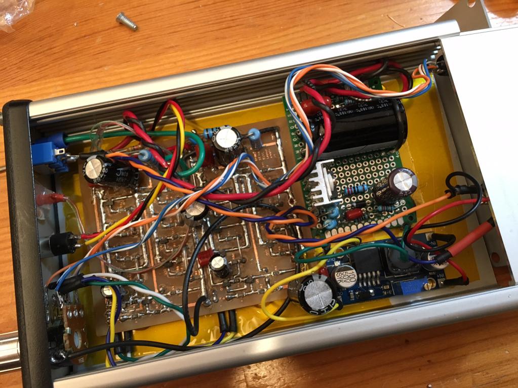

I just put another Easy Peassy Cap Mx into my SE Class A headamp. Using IRF540 MOSFET for 20v output. Fed by XL6009 step up DC-DC converter.
Bass authority seems to have improved noticeably. Amp was already quiet and now absolutely dead quiet.
Particulars: IRF540, 10k & 220uF cap and feedback, 1N4007 protection diode, 220R gate stopper, 1uF 230v MKT and 1.1R snubber, 10mF 25v output reservoir cap. Takes about 20 seconds to slowly turn on - so it's a nice soft-start feature to avoid turn on/off thump. Since current is only 100mA, using local heatsink for 400mW.
Isn't it great that those convertors do actually work - I've always been a bit hesitant because of the expected 'noise' but .....
