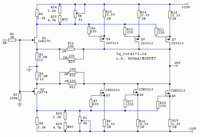

The F5 Juma is described here, but briefly the schematic looks like this:
It's very simple with a pair of little JFETs driving a whole gang of MOSFETs directly. I am using 4 pairs vs the 3 pairs shown in schematic. It has been confirmed by other builds that even 5 pairs can be driven and sound good.

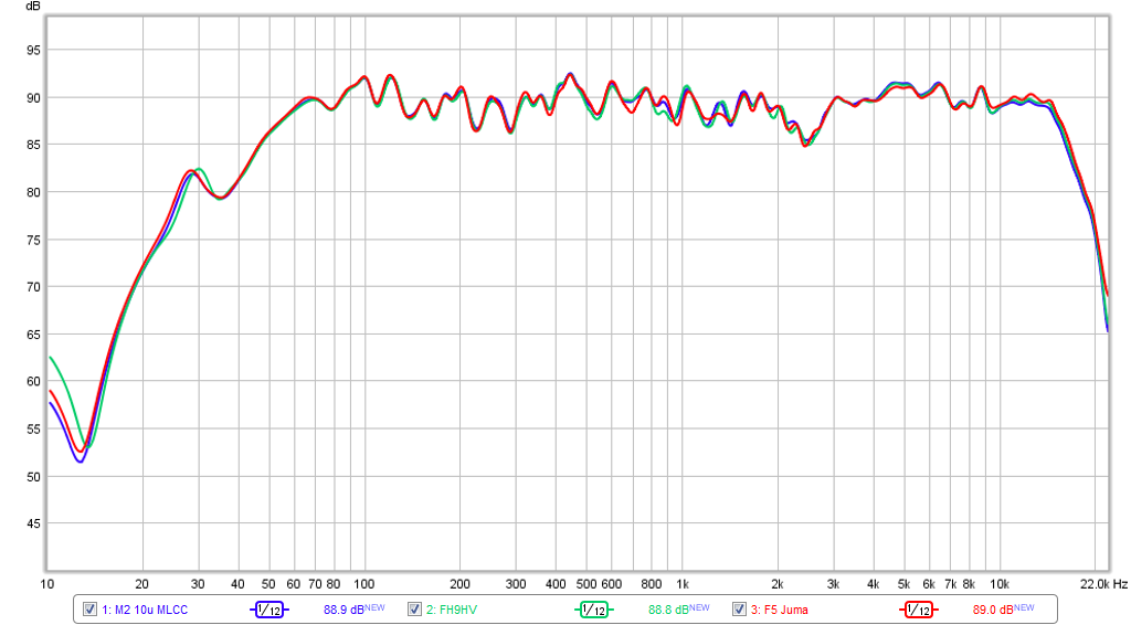

Here is the measured frequency response in comparison to the M2 and F9HV:

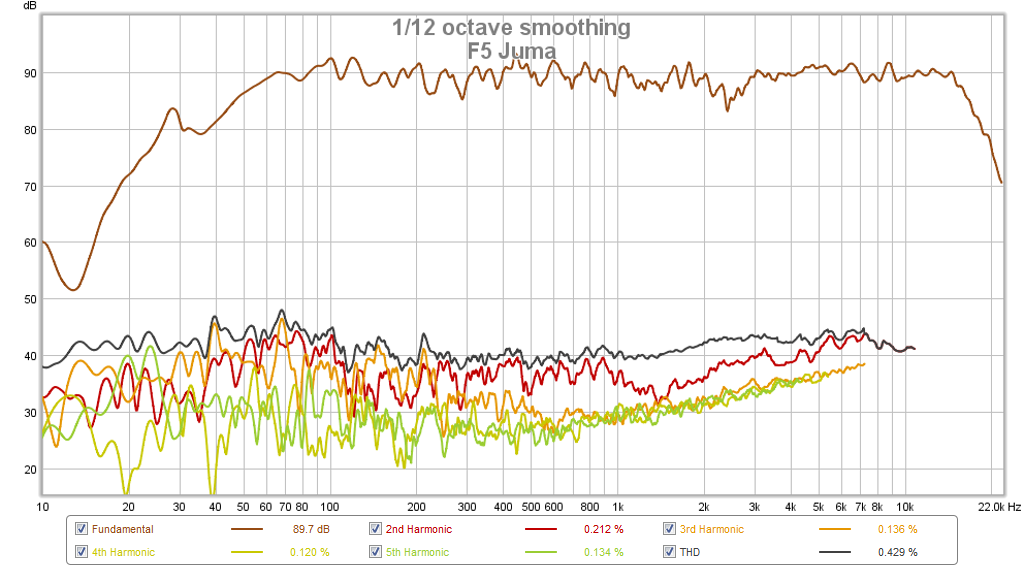

Here is the measured HD - note how uniform the components are and how low the bass distortion is - it drives the woofer with great control and has less HD below 100Hz than any other amp tested in this thread (IIRC):

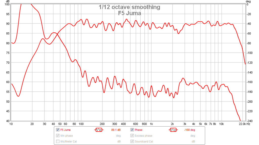

Here is the measured phase:

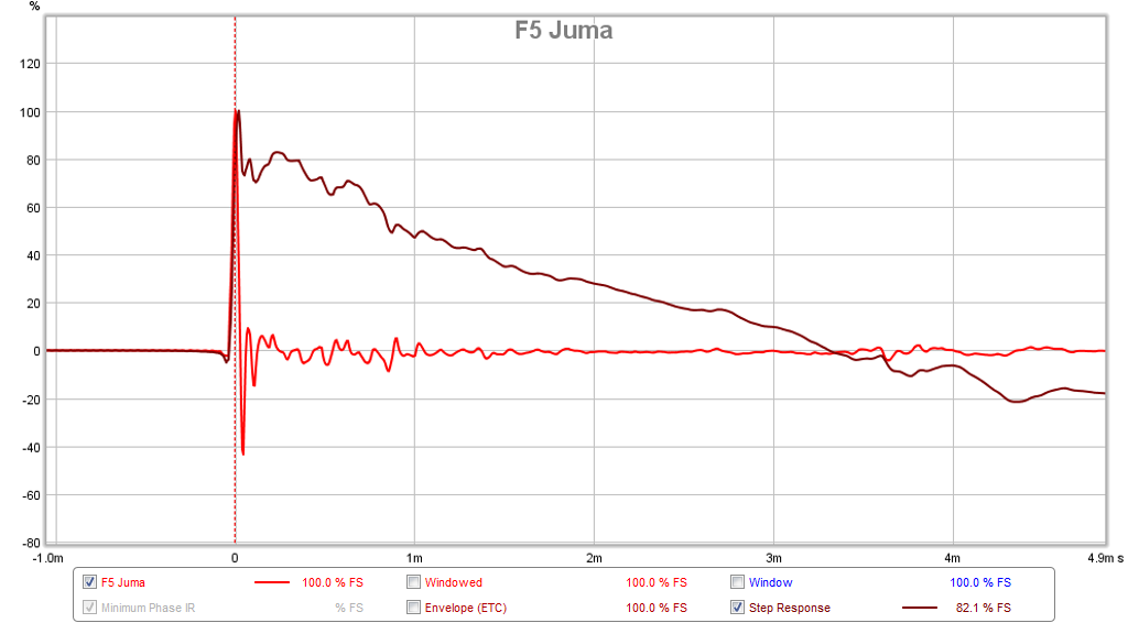

Here is the measured impulse and step response:

Hi xrk971,
many thanks for this interesting measurement,
Not sure, but I think there is a slight gap between this updated measurement of FH9 and the measurements on post #1, visible between 1kh and 1.8khz. maybe it is only a printing issue.... Have you change something on the PSU?
Except at 1.5khz, on your system, all of these amplifiers look quite similar in term of performance.
At 1.5khz FH9 looks better.
If my understanding is correct, Impulse and step response are not better than other amplifiers you measure... Quasi mofset looks better on this point.

The measurements above show FH9HV, M2 and F5. Earlier show FH9. Measurements really all look almost the same in frequency response - the small differences we hear are mostly harmonic profile and bass authority.

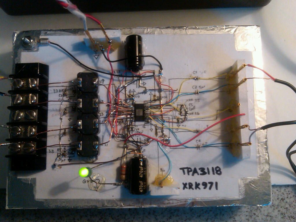

hi Xrk971, have you ever tried TPA3116 / TPA3118 ? class D amplifier from TI ? I curious about the sound compare to discrete amp
Oh yes. I was one of the first on this forum to build a TPA3118 amp from scratch. I used TPA3118/16 for years as my main active system amps. They work very well for what they are but are limited in their dynamics and bass authority. They lack the transient power to keep up with a good class AB amp in this forum like the Quasi by Ranchu/Aksa or the FH9 or CFH7. Those amps also have lower harmonic distortion at full power as well. Once you build one and hear one the differences are very clear. I pretty much have stopped using class D amps.
This was before cheap boards were ever available from China.
http://www.diyaudio.com/forums/clas...ding-them-everything-comes-6.html#post3413886
