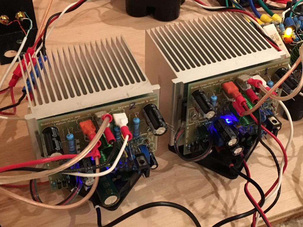

I just put my Quasi's back on and listening to them now. Forgot how nice they sound. 🙂

A BIG QUASI
Hi Marc,
This is a quick and dirty Spice schematic, so this is not built. (Some of the dissipations and currents/voltages on this schematic are not correct as they relate to the 42V rails, which I analysed very carefully but NOT this version). But I have no reason to think it would not work well as I did something like this five years ago! I have used an IRF90N20D here; the profile of the harmonic is very much driven by the choice of the mosfet. I would use a FQA69N25 Fairchild here, but don't have the model. Results are very good, and if you use C5200 (not fakes!) I would expect you could increase the rails to around 56V, no higher.
I have some concerns about stability at the clip on the negative waveform. This would come back to the B/C cap on the inverter, which should be a 4A device like the 2SA1837.
By using a 0.33R emitter resistor matched npns is not too critical, but it does help. This is a schemat, Marc, and would need some proto work, but it would be practical.
Harmonic Profile is excellent, better than the single npn version. Moreover, the mosfet NEVER turns off; at clip it's still passing more than 7mA.
Hugh

Nice schematic Hugh.
I noticed the addition of 2 small capacitors ; C8 (1nF) across D1 and C10 (12pF) across R5. These do not appear so far on any of the current PCB Layouts. (Prasi, Thiago and Dacz)
Should these 2 caps be added now before someone send these beautiful PCB to a PCB manuf ;-)

Eric,
I would not change either of them on Prasi's layout. It is fine as it stands. I include them on this higher power amp because I found issues with stability at negative waveform near clip (46Vpeak). You often find that more powerful amps need additional stability because their slew rate has to be higher.
