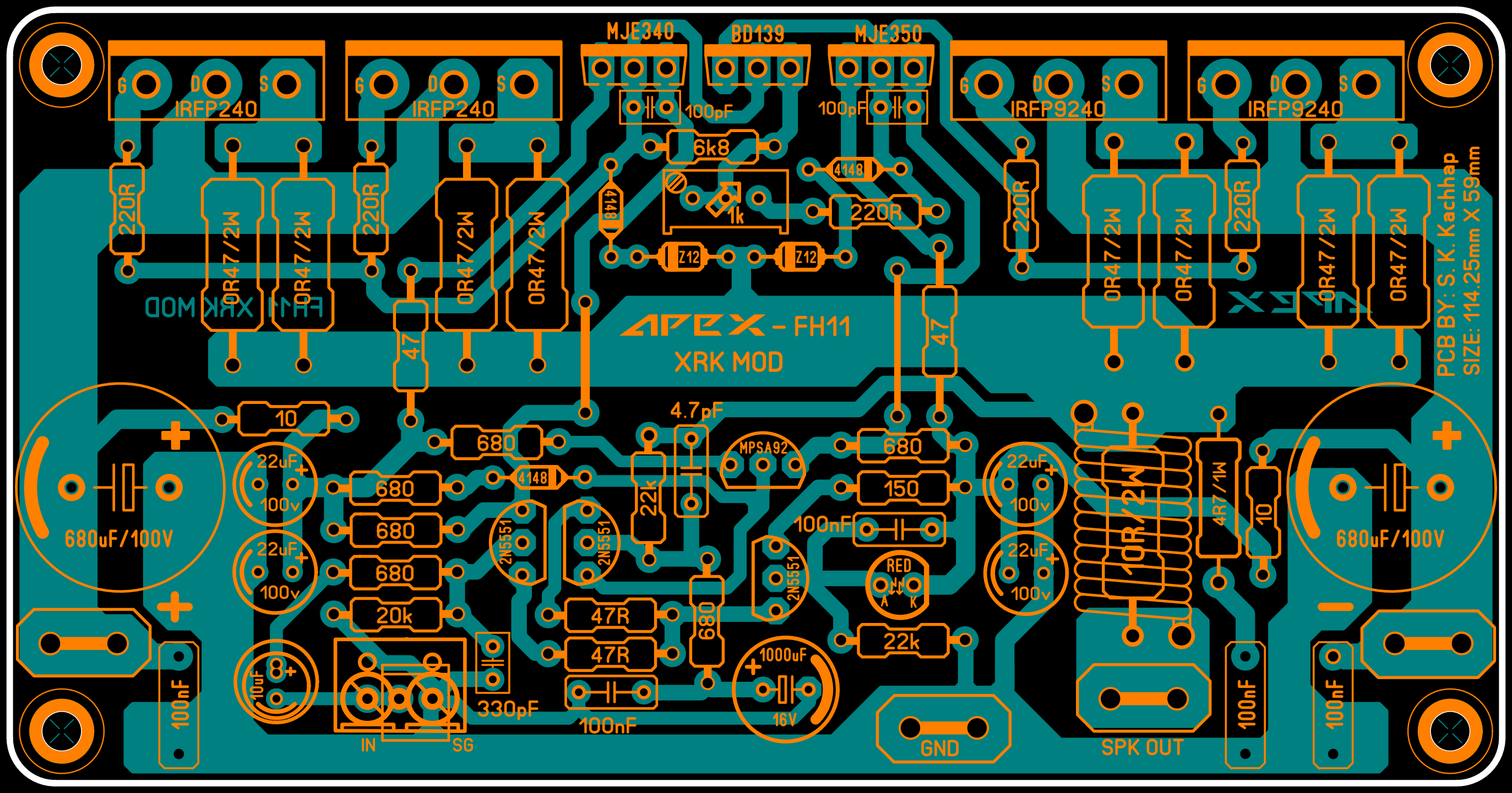

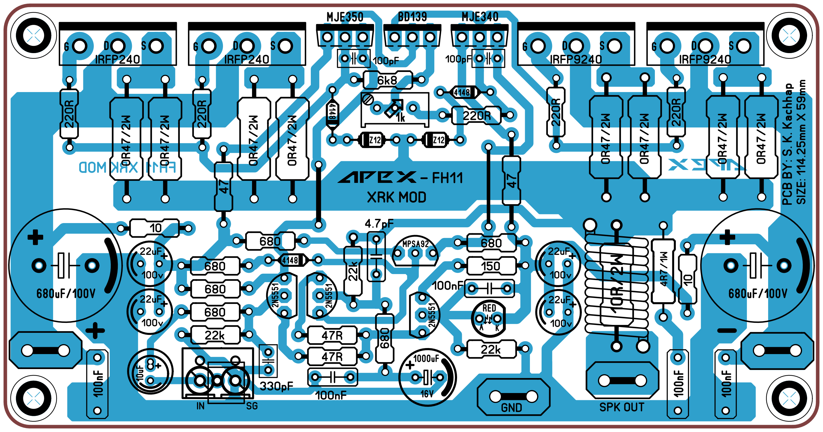

This is the old layout that Sonal is working on to correct the flipped electrolytics on. I am looking at it and can't find any other errors, and do see that it is a beautiful layout otherwise. If one was in a hurry, this could be used with a manual (note to self) to flip power rail electrolytics and it should work. It's a surprisingly compact and simple 250w amp though.
Sprint file for FH11. Pdf files will be shared after andrewlebon has tested it.
@andrewlebon If you use with voltage rail of 55v or less then use 1000uF/63v instead of 680uF and 47uF/63v instead of 22uF.
There was one more mistake MJE340 was in place of BD140 and MJE350 in place of BD139.

Sonal Kunal - thanks! Looks fantastic. 😀
It's very convenient that pin outs for BD139/140, KSC3503/KSA1831, MJE340/350 are the same. Note that on VHEX+ amp, vzaichenko drives a pair of IRFP's with a single KSC/KSA just fine so it may still be suitable to use those drivers. I believe they may have slightly better noise/performance figures over the MJE's.
I have both so it's not an issue - just wondering which will give best performance.
Then you should get KSC2690A/KSA1220A.
Thats a wonderful layout sonal:cheers::up:. very compact.. As Mr. Mile says, if it can be made to fit 100mmx 60mm or even 75mm, it will become pcbway/seedstudio friendly😉
reg
prasi
When I was making layout I visualized mounting holes on all corners. But with 100x60mm, pcb mounting hole at top is not possible.
I'll make two version.

I wouldn't dare ask to make it smaller 🙂
If it helps, I am using 1W 0.47R supply resistors in F9HV and they are not even warm. I also don't need/use screw holes on the edge with the OPS.
Beautiful and very builder friendly design though. The 100mmx60mm will mean qnty 10 for $10 from PCBWay 😀
I would like to mention that MPSA92 transistor will be getting quite hot when using high voltage rails and it will require a heatsink, which may present a challenge to some, since it is in a TO-92 package. An alternative would be to use a different transistor in a bigger TO-126 package instead.
