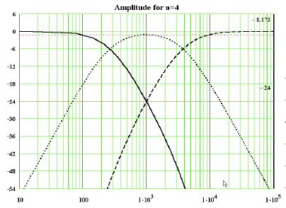

I need more information. Can you send me a private message. I need to see your crossover.
Most of the modeled crossovers I used where lacking. I've learned a few things over the last 7 years.

Did you just model the crossover ? There wasn't much info on how you arrived at your eye wateringly expensive XO

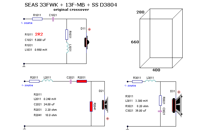

My XO looks now like this :
In the red Box on the XO i have tested and this things dident sound good to me. ( Only dident testet on the Bass what is in the red box )
I`m missing some smoothness on my Tweeters and high-mids.

First order crossovers you keep in phase. second order you invert phase as a general rule of thumb.
A test microphone is a really good investment.

If you post the schematic on PE tech talk you might well get some constructive replies as the guys there really know their X/O stuff
Robert, since you asked me to look in, I'll add some brief thoughts.
The Classic 3 way uses much steeper filters than you here:
A typical implementation of Steen Duelund's ideas here:
SEAS-3-Way-Classic
Shallower filters can use the SEAS 503 ideas:
http://www.diyaudio.com/forums/multi-way/279278-4-way-series-crossover-accuton-acoustic-elegance-drivers-12.html#post4525459
Needs a good mid, or TWO!
SEAS-3-Way-Classic

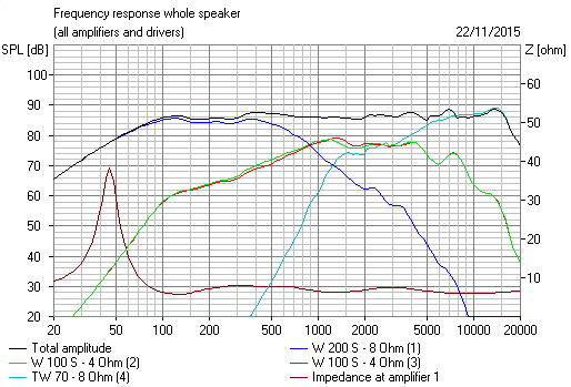

System7 :
Thank you for the effort and I will have to invest many , many hours to make my onwn 2nd order XO.
This will be my first one I will design by myself. I will post my material here.
Is there any simpeler program than boxsim - visaton for XO design. If not then are somewhere data do download for my drivers : ?
