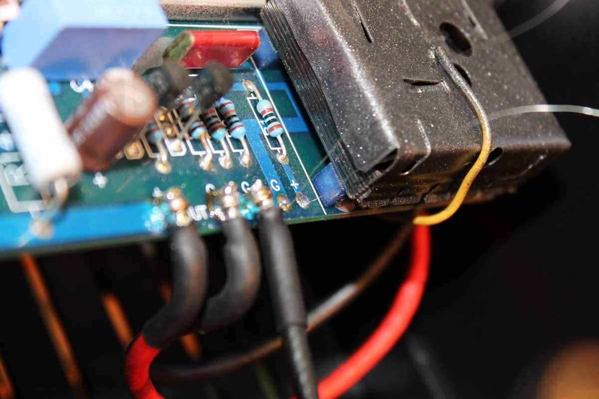

And something else.
Is solid 1.5mm copper wire adequate for the power lines? I have some 2,5mm multistrand but it does not properly fit the pcb holes.
And something else.
avoid solid core connecting to pcbs , you'll have reliability issues in time
think about vibrations
regarding bigger wire - superfine loudsp wire is flexible and nice for task
see how :
Papa’s Koan (M)2 , an amp for living room | Zen Mod Blog
see how :
