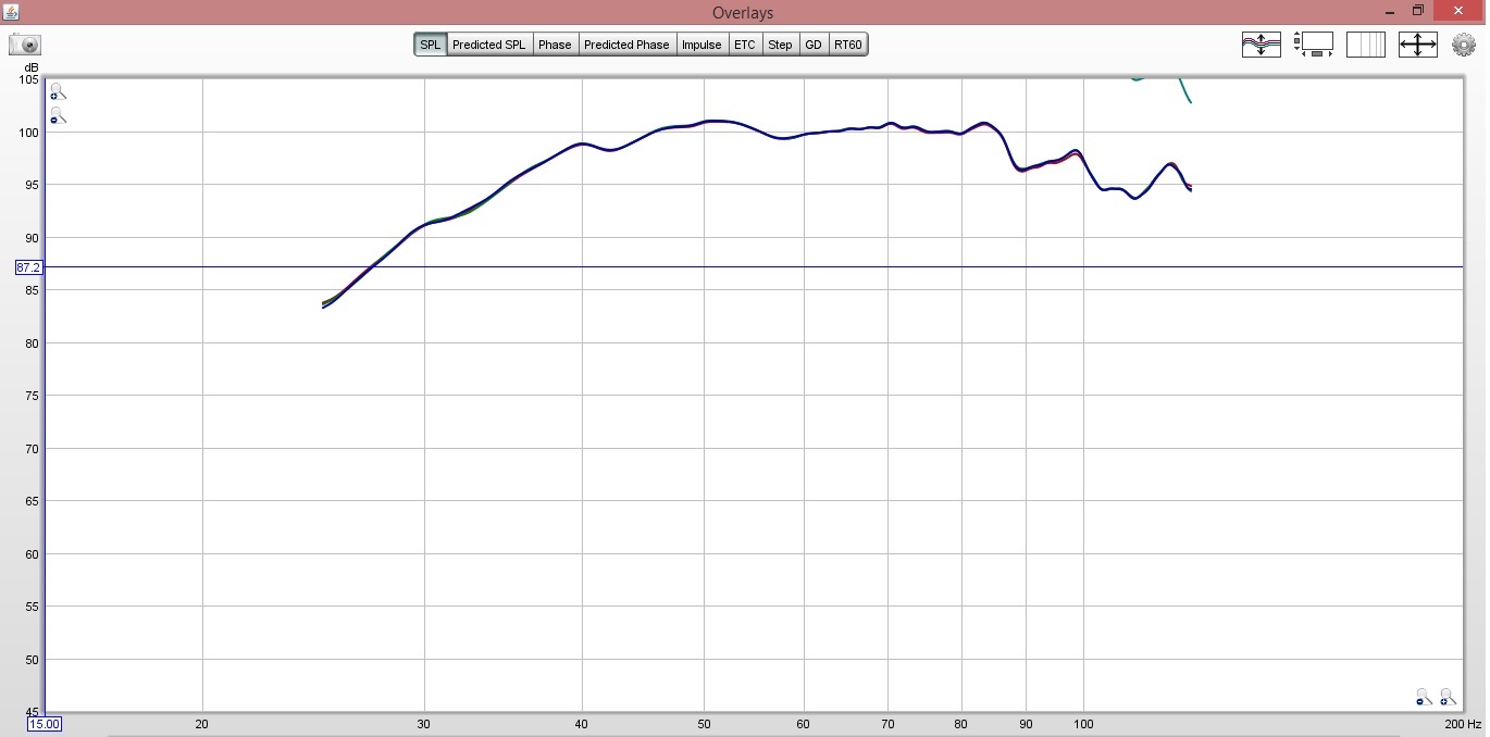

Do you have a measurement mic? It would be great if you could make a measurement in an open field or parking lot at 1m and 2.83v so I can see how well the sim worked. Also useful is measurement at very low power with mic at exit plane of port or mouth. If you want to get serious about speaker building, a mic is indispensable. I use the Dayton UMM-6 and REW software.
If you can upload a video with sheet of paper at the mouth or duct flapping with deep bass playing that would be cool to see.
How i setup and used the REW software
Download and install REW. Connect mic and run program. Go into setup to configure mic to make sure it works. If you have cal file install file. Click measure button. Need to connect amp to headphone out of pc or laptop soundcard. Set the gain on soubd card and set amp level so mic doesn't clip.
This is what I get. I don't know if it is correct. I measure it at 2.83v with the mic close to the box

Your measurement is tracking the prediction as it is down -5dB from 50Hz at 35Hz. You may have some room modes going on around 80-100hz that is causing those dips. The sensitivity I can't tell unless you measure how far away the mic is and wire it 2ohms (series within ea driver and parallel between drivers). 100dB with. 2.83v at 8ohm isn't bad though. Can you post the harmonic distortion tab? Pick all harmonics up to 5th.
Here is prediction without extension duct:

Xrk971,
Much thanks to you, Tb46 and the rest of guys for making this project possible.Working and this project I learn a few thanks that i will keep in mind for my next project.

You are welcome! Thanks for following thru to a build. Often times we help folks with designs that never get realized. Hope you enjoy the fruits of your creation. If you don't mind, please make a measurement with the extension duct in place at 2.83v and 1m with sub flat on ground. Take data from 10Hz to 2kHz without any filters in place so we can see predicted vs measured data.
X
If you can't go outside then make a very low amplitude measurement with mic at plane of duct is ok.
