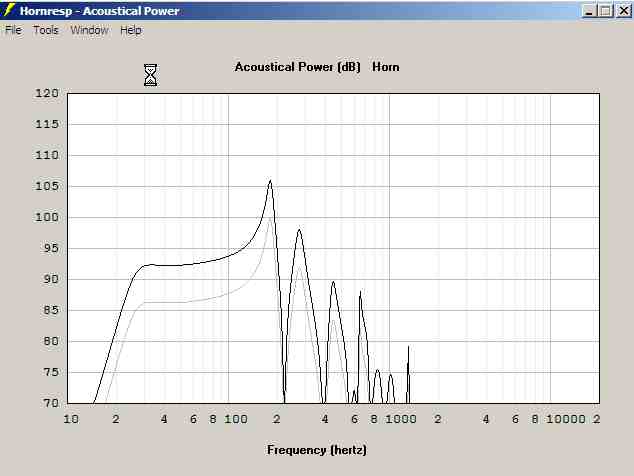

I think it would not be a problem. What does it look like in AkAbak? In Hornresp it does not matter, you get the usual offset because of increased input power if you go series v. parallel without adjusting the Eg, but Hornresp looks at it a bit differently. I'll attach my Hornresp simulation with the warning, that it is not going to be quite the same as your AkAbak simulation.
