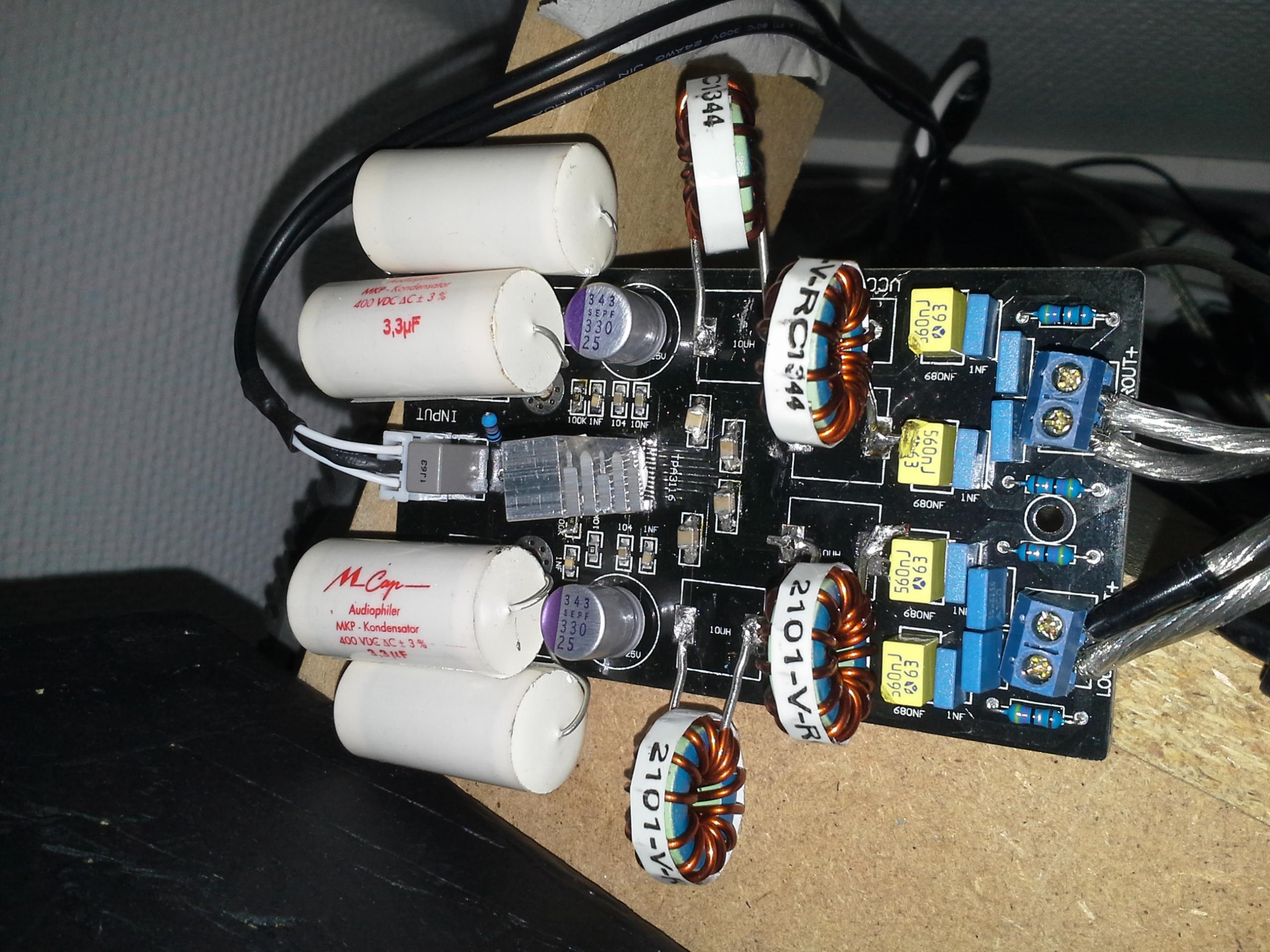

This is my latest find. I have modded it with four 3.3uF Mundorf M-cap MKP input caps (that made the power-on pop go even more boom! although I got a little more bass), 10uH bourns inductors (see sticker for model), x7r 220uf SMD caps, the recommended 330uF panasonic power caps, a simple 100K log stereo volume pot, and a $5 Sony 19.5V laptop brick (see pic). The difference between the 12V 6A LED light brick was 2A3 tube amp like sound quality (although still with some class D sharpness) and even more surprisingly - no more frightening power-on maximum excursion pop in my speakers!
Thanks y'all! Now I will take a break on the TPA3116D2 and start building the Pass Camp Amp to compare.
Edit: The power on pop returned when the volume pot is at medium. But no pop when volume pot is at 0. No anti-pop circuit used - I tried it, although using the wrong values in resistors and caps, and liked it better without. makes me think I should use a 100 uf cap at the volume pot. No?

Nice work Rewind! Mundorf on steroids! This reminds me of Mad Max's souped up Mustang Mach3 from the Road Warrior :car:
See the similarities?
Looking forward to your ACA build and comparo. My guess is that the 50watt headroom on the 3116 will blow away any class A advantage you have with the ACA, unless you are listening with 95dB+ sensitive speakers.
I have the parts for an ACA waiting to go, but no time to build...
I also bought the same board as you, there is no pops for any of my turn on or turn off, just the base is kind of thin at the moment, I changed the power supply cap to a 470uf 50V and not sure if I need to change the power cap again. I am also using 330uf x 40 35V before going into the board power inlet, I will add a choke inbetween them.
I changed the power supply caps to the TI recomended 220uf 35v...and used Nichicon FG. I just looked at the TI data sheet and bought something of a nice quality in the value recommended. Someone said something about too much capacitance could be bad. The bass response i'm getting is great. I'm running it with some Infinity RS 2000's I bought at the thrift store for $5.99 and re-foamed. This seemed like the only obvious/easy mod to do with Audiobah so I didn't even listen before changing the caps I just did it because I didn't want to mess around with removing the board after installing in my enclosure.

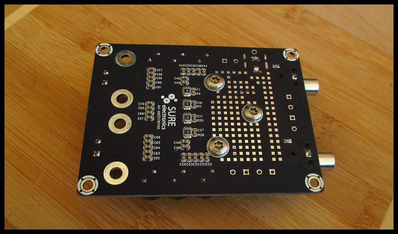

I hope to finally get around to listening to SURE's new TPA3116 this week. I like the newest version of the little TPA3110 with filter and expect this one to be nice too. Not sure why the need for such a massive heat-sink that weighs in at 45 grams.
It looks like Sure implemented the bootstrap snubbers. I wonder how this amp sounds?
I'm also eager to hear your impressions of the Sure tpa3116.
The original Sure tpa3110 (the $10 one without any output filter) sent me down this rabbit hole in the first place. I remember someone over on AudioCircle said it was amazing, and I figured, for $10, I had nothing to lose. And indeed, I noticed an immediate improvement over the HiFiMeDIY T1 TK2050-based amp I was using. Here I am a couple years later, and besides the original Sure tpa3110: two YJblue boards, two Ybdz boards, two mono DUG GB boards on the way...
How hard was it to remove that big heatsink?
If I read the specs right, Sure's 3116 is the same size as their original 3110, which is roughly the size of a credit card.

The heatsink is easy to remove and replace if you have the right tool. You have to carefully line up the three nylon washers when re-assembling.
The posted dimensions are wrong in SURE’s Amplifier Users Guide. Here are the actual dimensions.
SURE TPA3110 type 1 AA-AB32231........ 76mm x 50mm
SURE TPA3110 type 2 AA-AB32996........ 92mm x 68mm
SURE TPA3116.......... AA-AB32178........ 92mm x 68mm
I’m just now giving it a good listen.
It certainly has a lot promise as an off the shelf project amp.
The initial sound right out of the box is quite a bit different from the new and similar build of the TPA3110 from SURE, which has more relaxed presentation right out of the box.
This new 3116 from SURE has a more lively sound, increased dynamics and PRaT but also sounds like it’ll need a little more breaking in for the extended highs to relax.
Both are totally stock and have only an hour or two on them now as I listen back and forth. They both have a very different approach to delivering the music.
I’ll cook them both with a test disc under a load tonight and give them a listen tomorrow.
I expect them to be like all the other TPA31XX chips in that they are certainly sensitive to power supplies, front end equipment and preamps that are feeding them and with some help are capable of making music that belies their price point.
