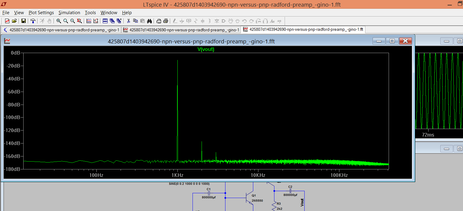

To get good simulation results you need to run the simulation for long enough. That's the "tran xxx" setting. 400us gives just 8 complete cycles. 4000us gives ten times as many (make sure you have enough cycles set up in the source voltage to cover the time the sim runs).
Look at the settings here. I altered it to run over 3ms to 4ms (so its looking at the last 25% of the run). The slope on this FFT is caused by having the caps at 1uf, so they are confusing the result as the circuit stabilises. Making the caps massive removes that problem, they are so large that nothing materially changes during the brief simulation run.
I tried ... not working with the followin settings in the window
Edit Simulation Command
Stop Time = 4000u
Select waveforms to include in the FFT
Start Time = 3ms
Stop Time = 4 ms
Number of data point samples in time = 65536
I think i have a problem with the X axis because the graph starts from 1kHz ...
Thanks, gino
