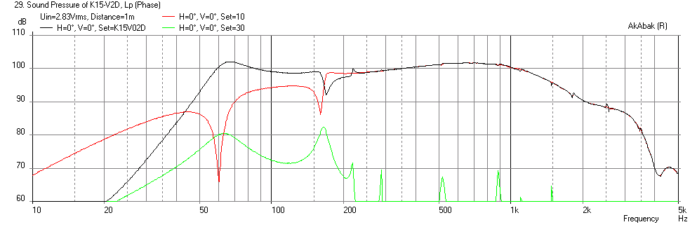

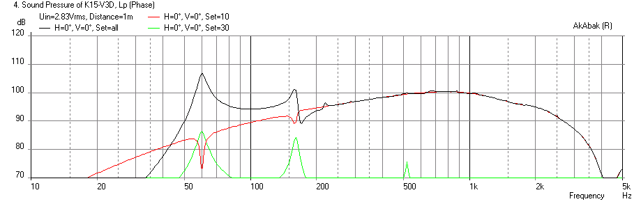

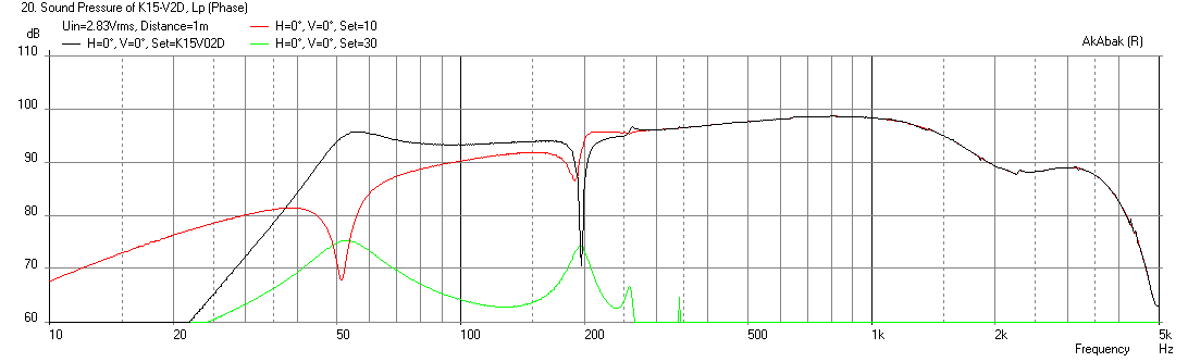

K15 (scaled down) works well with TB W8-1772 and Lowther PM6C
To get this established back in the proper thread and also just in case you may have missed this because it was sort of OT and posted in this thread: http://www.diyaudio.com/forums/full-range/162253-build-thread-k-slot-rear-loaded-horn-tangband-w8-1772-a-12.html
It turns out that the K15 can work really well (K15 cabinet scaled down to 12/15 x length and 8/15 x width) with the W8-1772 and PM6C. The sims show excellent bass extension down to mid 40's Hz and ideal impulse response meaning the dynamics will be excellent. You may do a double take seeing a Karlson and Lowther paired together - but they seems to be well-matched. 🙂
Here are the freq responses:
Tang Band W8-1772
Lowther PM6C
Similarly, the Audio Nirvana 10 works perfectly in a full-size K15
All of these sims are for placement very far away from walls and now include damping in the back chamber (different than the K15 plans which call for pads, I actually have stuffing in the upper chamber and lower chamber but none around the vent or rear shelf). It seems to help smooth out the response without impacting efficiency.
Tang Band W8-1772
Lowther PM6C

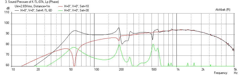

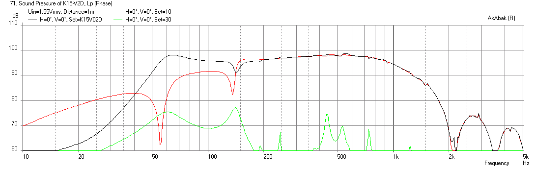

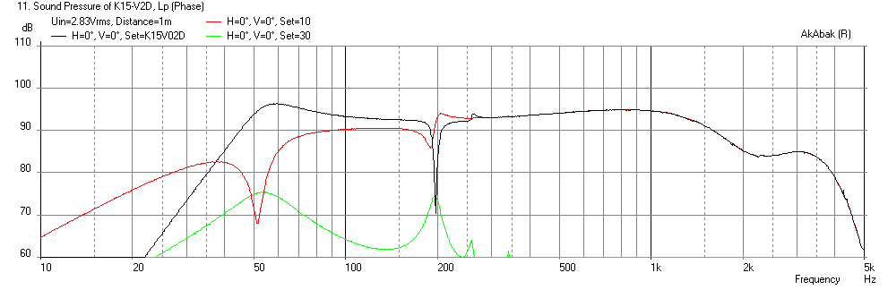

I don't think the Beta 8A is a good fit for the Karlson K15 (or K12) - there is a peaky bass punch. See simulation below. I think a better performance can be had in a Karlsonator scaled to 12/15x. Use the CD to fill in the top end above 2.5kHz with the standard Eminence crossover. Use K-tube horn or a wide angle 90 deg horn.
K15:
Karlsonator scaled 12/15x:
K15:
