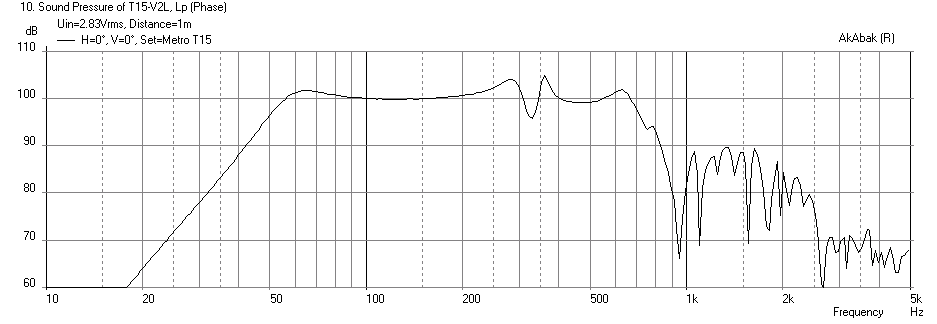

After researching subs and horns for a couple years (besides performing on a fair number of PAs most years) the T15 is looking promising, I'm considering the possibility of eating a few inches to move Fb a bit lower (is that done by a larger back chamber or a longer path from front to back or both?)... Even if 3 inches bigger
Anthony,
I can run some cases with a cabinet that is 3 in deeper to see what the additional Vb will do. It certainly will bring the bass extension lower but how much we will have to wait and see. I already tried extending the front chamber by folding it one more time and wrapping it around the back - no luck there as it only made the sharp notch deeper but did not affect low end extension.
Anthony,
Did you move the vent with it?

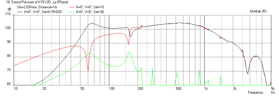

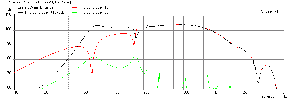

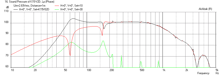

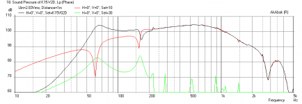

K15 for comparison with T15
I wanted to see what the performance of the K15 is with the Kilomax 15, Kappa 15A, and B&C 15HCX76 in similar setting of a large stadium (walls really far away), and I have added damping into the back chamber. There is no doubt that the K15 is a time-tested design if you look at the incredibly wide and flat bass shelf which makes it ideal for crossing over higher (around 1.25 kHz - perfect for a coaxial horn).
- SPL vs Freq for Kilomax 15
- SPL vs Freq for Kappa 15A
- SPL vs Freq for B&C 15HCX76

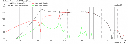

- SPL vs Freq for Kilomax 15 with 300 watts input at 6 meters away

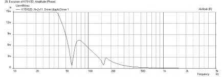

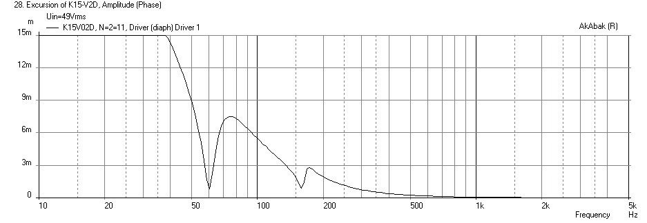

- Cone displacement for Kilomax 15 with 300 watts input
At 300 watts power, the linear xmax of the Kilomax 15 driver is reached at about 50 Hz. The efficiency of the K15 is really incredible when paired with pro audio drivers.

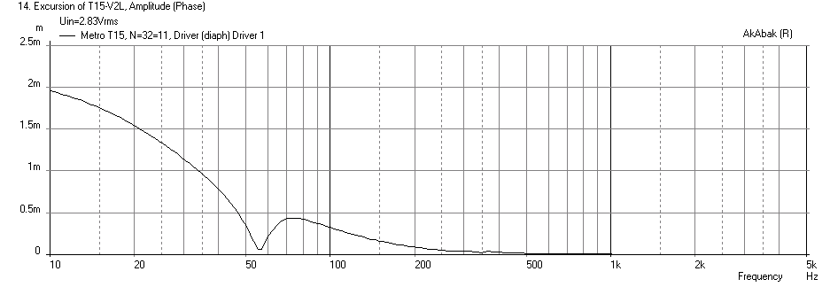

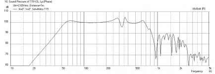

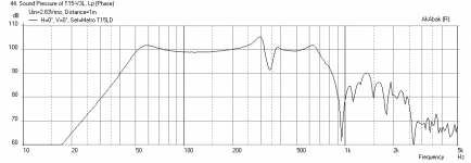

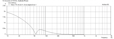

T15 with added 3 in depth
I added 3 inches to the depth of the T15 cabinet to give more Vb. I also increased the length of the internal vent by 4 inches to 10.5 inches long. This provides a bit more bass extension which is now 100 dB at 55 Hz and is down 3 dB at 50 Hz. This should be able to capture the punch of a 50 Hz kick drum better with only a nominal gain in cabinet size.
- SPL vs Freq for 2.83V input at 1 meter

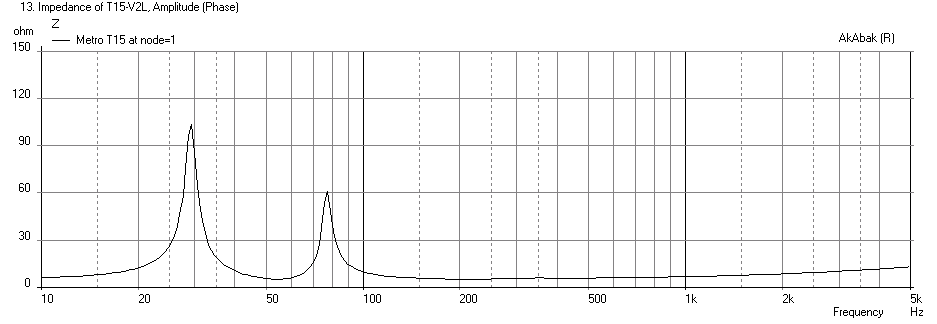

- Impedance
370211d1378731551-speaker-kicks-butt-large-spaces-t15-plus-3in-kilomax15-impedance.png
- Cone displacement

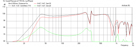

T15 with Added 3 in depth & Extra Fold on TL
I added an extra fold on the back of the T15 Grande (+3in) so the 3.5 in tall channel makes a 90 deg turn that tapers to 1.75 in at the bottom of the cabinet. This seems to bring the bass extension solidly into the 50 Hz territory at the expense of a few dB in efficiency and there is a slight sag (-1.5 dB at 120 Hz) in the response indicative of over-extending a driver's bass response. So this configuration adds +6.5 in to the depth of the cabinet.
370226d1378737699-speaker-kicks-butt-large-spaces-t15-plus-3in-longtl-kilomax15-freq-1m.png

Even so the K15 is 5 linear inches larger than our +3" T15 Grande (and 8" over our base T15), & our T15 stacks better without being precarious and is giving us extended LF (and I like the visual aesthetic better although I'm skeptical of front chamber optimizations in the T15). All this feels like ample justification for our Karlson sub.
Returning to the T15, the +3" grande version is looking good but I do wish we knew how to move the notch down to cut at 250hz (if the notch had a rising edge starting at 180-190hz rising to 220hz before dipping at 250hz and then bouncing back with some overshoot near 280-300hz)... Rather than a response aberration that needs corrective EQ we could hijack it as a subtle clarifying EQ. It would reduce common buildup/mud @ 250hz while the gain at 200hz would emphasize guitar and bass separation and the gain between 280hz and 300hz increases bass note presence with boost of upper harmonics and female voices would benefit as well.
Any ideas why it's so low on a K15 and so high on the T15?
The K15 notch in your graph is around 170hz.
That's a QW of 19.5"
1/2WL 39"
1W 78"
The T15-Grande notch is centered around 329hz.
That's a QW of 10.25"

Not sure if you are interested in getting more bass extension with the T15 (with Kilomax 15 driver) but I simply added 7% more volume to the back chamber and here is what I get: solid extension to 40 Hz and a slight sag in response (-3 dB in the 60 to 100 Hz range). Also there is a deeper notch at 240 Hz. Just putting it out there...
370755d1379003200-speaker-kicks-butt-large-spaces-t15-kilomax15-freq-1m-7percent-back-chamber.png

Hey X, Thanks for exploring the LF... I liked the extension reached on your T15grandeTL version as it didn't sag as much as this one. When I get to cutting wood I'll mock up a few of these quickly with cheaper ply.
Regarding the Notch at 240hz, I wish! It's at 340hz right in the middle of some prime real-estate... If we ever discover how to move that notch around,,, (I haven't had time to do path-length comparisons between different models, but there should be ample clues present in all of Freddi's measurements & your akabak predictions). I'm pretty confident I would trade 600hz extension for 500 if the notch moved accordingly. This coming from someone who spends ~6 hours a day 6 days a week mixing music in a home studio on mastering grade monitors.
Interesting that Freddie's 18" in a K15+20lt cavity has the notch at 350hz our T15... His 18"K15 without the 20lt cavity moves the notch -20hz to 330hz.
Lots of questions... Really want to make some dust but caught up in finishing a record at the moment.
Anthony Bisset,
I have tried several things and unable to move that notch. I even tried adding a shelf on the front chamber, making the front chamber longer, making the rear chamber volume greater, changing vent length. Maybe Freddi or IG knows what controls the notch location on the T15? If you have some ideas what to try I will see if I can put them in the model.
