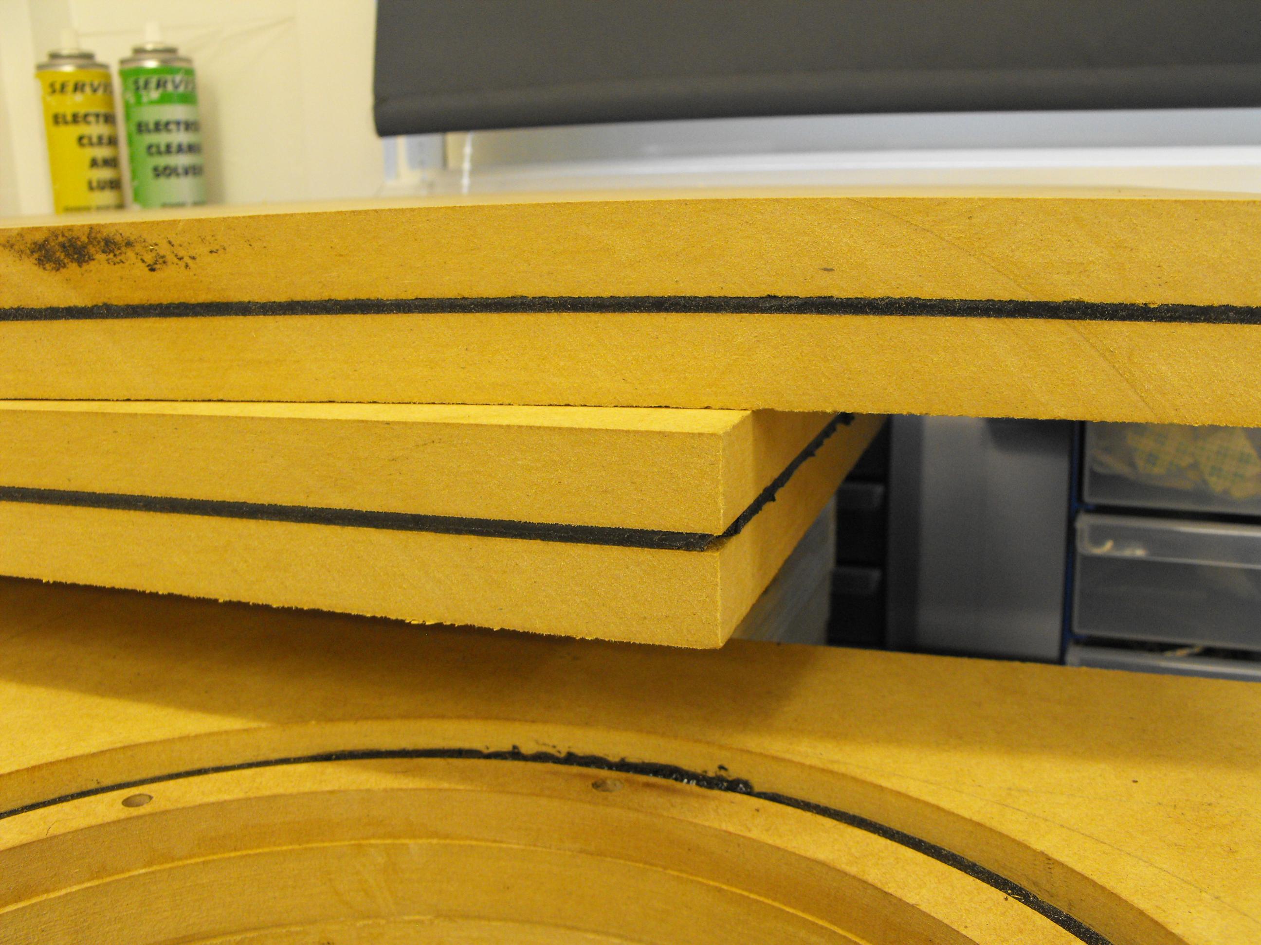

I know quite well about the CLD but I stand next to my claim; see the attached measurements. the black curve is the naked cabinet the blue curve is the cabinet with added CLD on the back only but the results are similar (just amplified) for more surfaces treated with the CLD.
The damping does nothing for the first few modes.

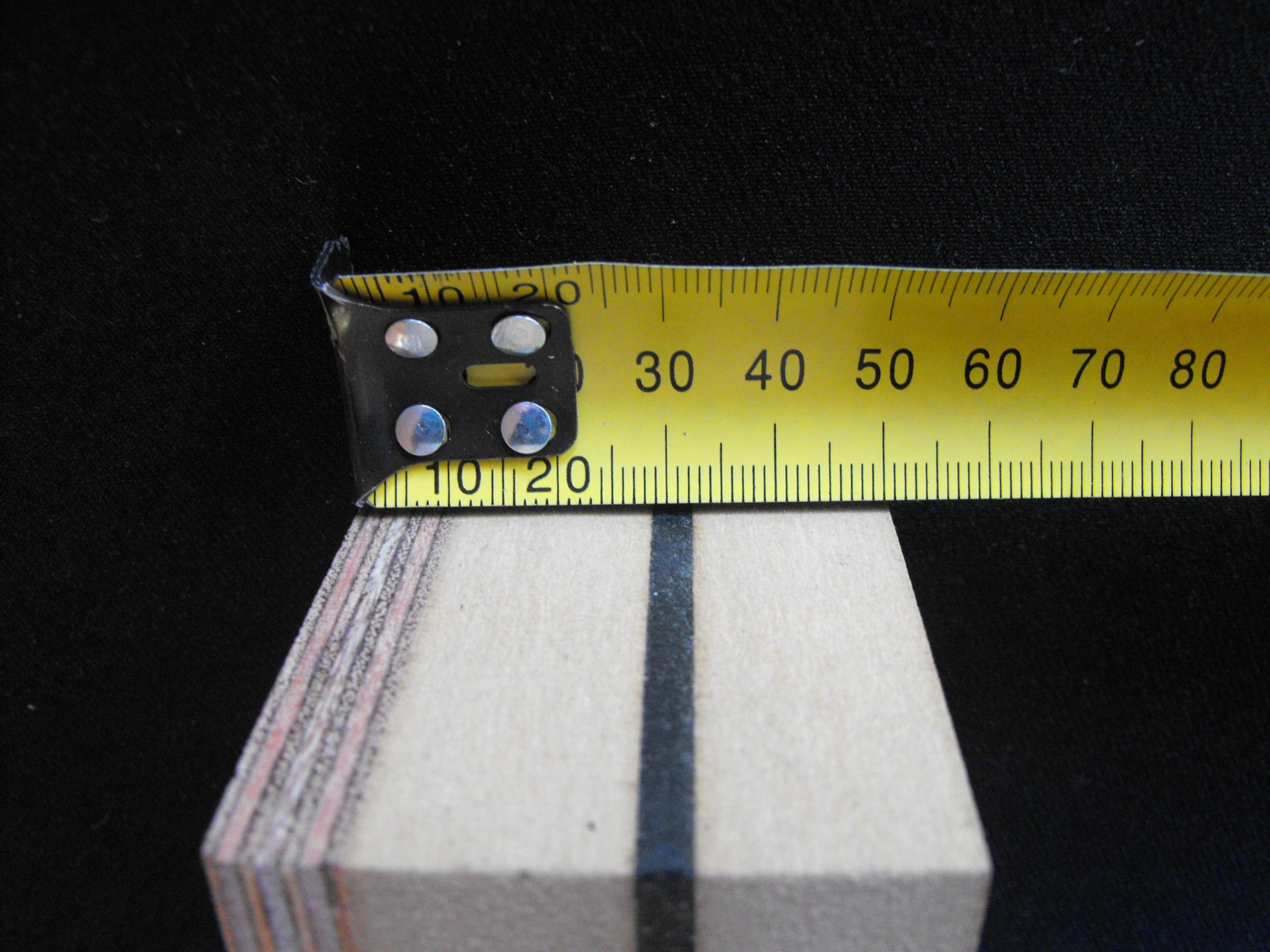

Sikaflex polyurethane was the best but the most expensive so he went with Bostik V60 glazing silicone that was almost as good.
A while ago I did some tests with simple 6 mm sheets of MDF and different intermediate layers. A 1 mm thick PU foam double-sided adhesive tape proved best. Easy to apply, but way too expensive for a complete speaker. Can't find the results anymore, but AFAIR it damped the modes nearly completely.
Seems like PU is somewhat good for that purpose.

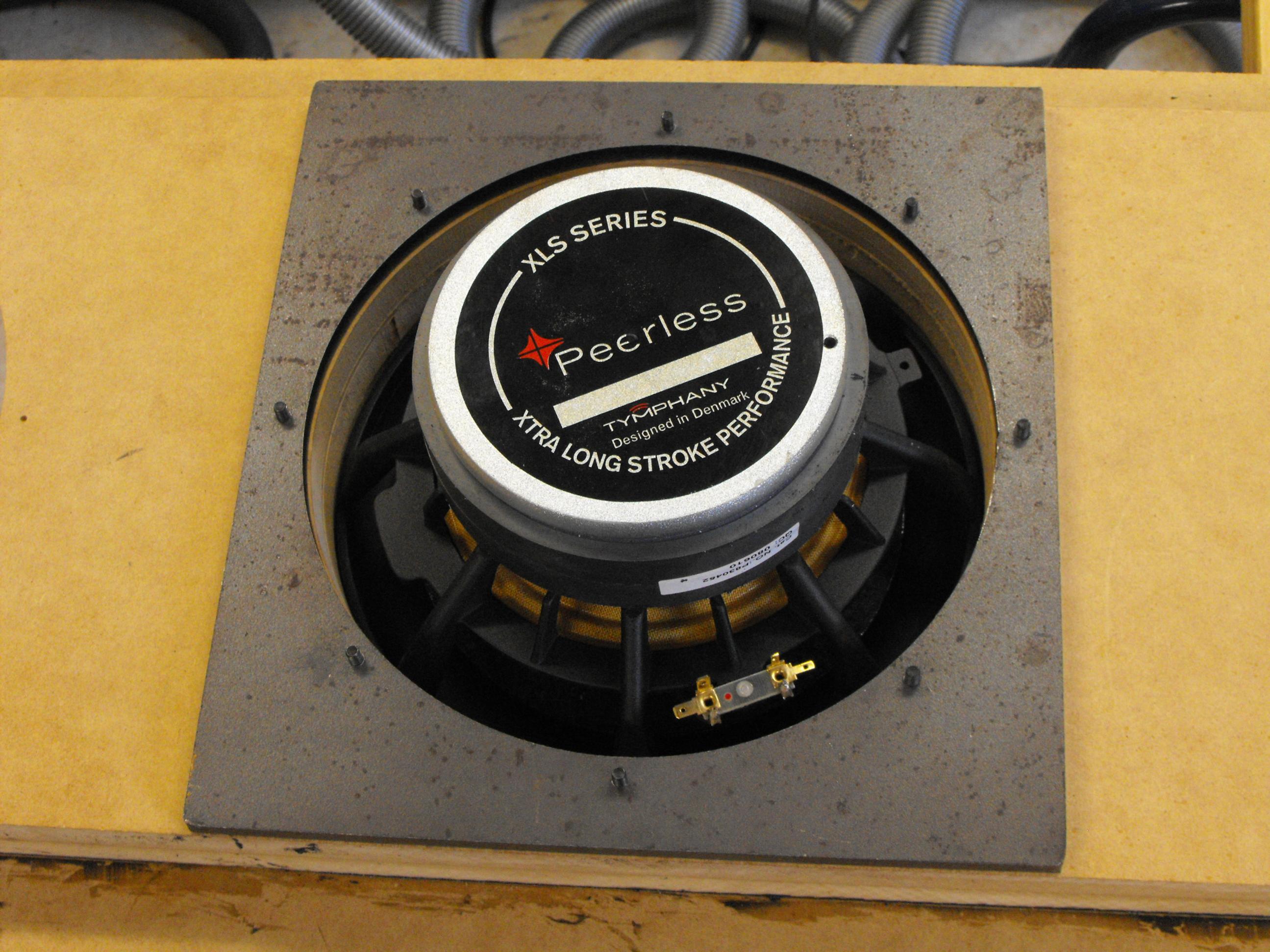

Beautiful on the outside; but this is example of horrible way to mount drivers:
Deep cavity constrains air motion, and sets up cavity resonance. In case of woofer this may be well above crossover point, but is pumped mode. For all the reduced cabinet sound, this cavity resonance is adding way more color.
In case of this projects mid range:
The mid range is effectively mounted in short pipe with horrible resonance. This is bad compromise.
Designer can't loose sight of what is going on inside the cabinet that effects what comes out of the driver.
In case of above mid, the baffle element that is mounted in has small irregular shape; this alone greatly reduces how much sound this panel is radiating.
