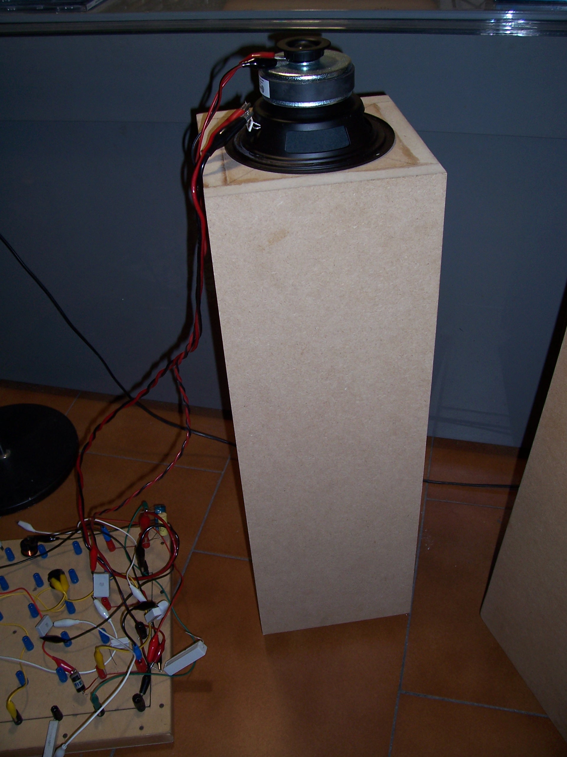

Will add this. It was like I only needed to add one front firing 6.5 to the mix and it would balance. Vocals were seemless and balanced and regardless of height/position or orientation the AIR was always there. Something I think Esperanza Spalding would say is necessary for your soul
I appreciate that, honestly, I just like to experiment and build. It's very rare that a few days goes by when I don't have sawdust or paint on me 🙂

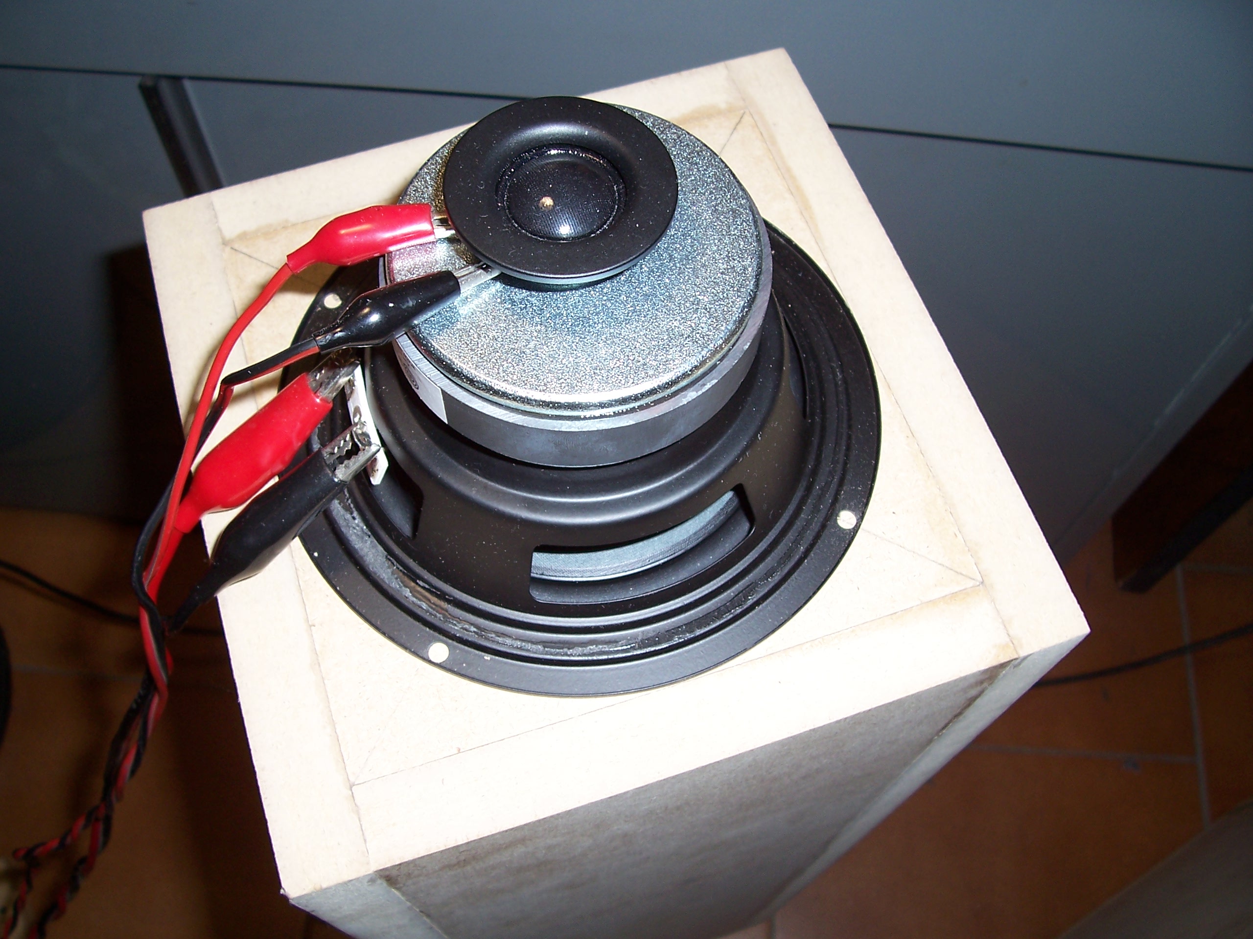

I've constructed short full range speakers, and placed as described in post #1.
Imaging above speaker is frequency dependent and listener distance and listener height dependent.
This is crappy compared to same speaker placed on stand to make it forward firing full range placed at about ear height for preferred listening position.

Can You please give us some more details? Type of the driver, size and proportions of the box, size and proportions of the room and of the stereo triangle etc?
Sorry again for the late answer. I'm lagging behind quite a bit reading this thread. 🙁
