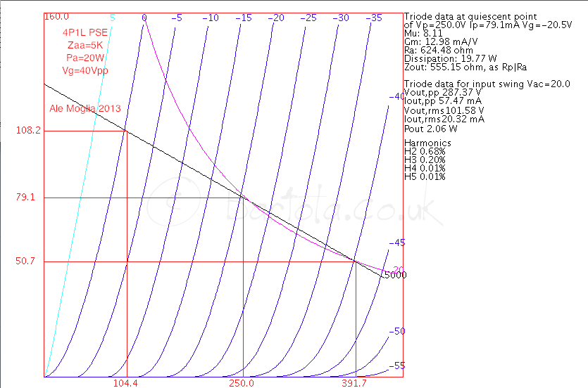

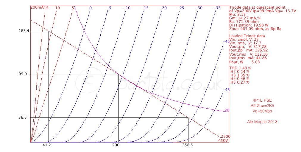

I was wondering about driving PSE 4P1L with 2C22, pretty much half a 6SN7. I'm wondering if it would work in two stages if I had 2v coming out of my DAC, like an ODAC for instance. I have Mark Audio Alpair 10s. It would be marginal. Right now I get about 0.5v from my DAC with 3 stages, 26>4P1L>4P1L.
Why don't you use an ECC40? You would get 2W out, as shown by Ale, with 0.5V rms in.
You can use the ECC40 both for min. THD and tune it for H2 cancellation being the main component of the spectrum.
There you have a two-stages PSE with 5 valves only....
I have an amp with a ECC40 input. I can see your point about the gain, but I prefer DHTs. I suppose I should look at a 2-stage amp. It certainly makes sense, but the only tube I know that sounds remotely like a DHT is the 2E22, and I'm not sure about that either. I do transformer couple, so one thing I should look at is sneaking in a 2x step-up somewhere. I suspect the likely place for more gain is in the DAC stage somewhere. I'm only inputting 0.5v to my preamp, and it can't be hard to improve on that!
Thank you Ale!
In my experiment I had about 220V on anode, so at clipping level of H2 was slightly less, level of H3 was slightly high, so dynamic distortions caused by "rectification" of an envelope were slightly lower. However, in the original schematic negative supply for cathode follower need to have more voltage, because despite of almost cut-off of output tube on clipping hard clipping of the current source was still audible.
