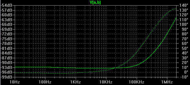

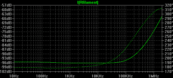

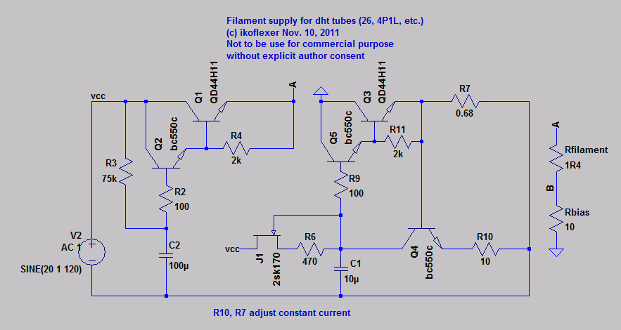

Pano, if you don't already have Rod Coleman's filament supply have a look at this little circuit which is based on the same idea, a CCS after the filament, and a bjt filter before it. I have used both Rod's circuit and mine in my 26 preamp and could not tell the difference (sound or measurement wise). All kind of different power bjts can be used, of course. I developed this after ordering a pair of Rod's supply because I ran out of patience. 🙂
Thanks Iko! I'll look into it. At the moment I'm running the filaments in CV mode from a lab power supply. Overkill, but convenient for prototyping. I could run in CC mode, too.

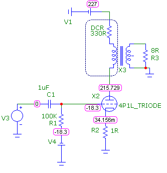

Below is the output circuit that I'm running now. The DC voltages are from the sim'd model and agree with measurements. The 330R is the DCR of the primary.
Even in the messy wiring stage noise is OK, about 27mV into an 8 ohm load. With the vintage Tamura iron I'm running the -3dB points are 12Hz-38Khz. Not bad, really.
What would be a real (as in something that is available off the shelf) qd44h11transistor ?
The venerable D44H11 like here: D44H11 STMicroelectronics | Mouser
However, I've used D1912 successfully as well.
I've been running my prototype with triode input and output stages. Getting about 2.8V RMS out before clipping. (5K:8 ohm) Seems that the output stage is clipping before the input stage, so will have to revisit my bias on those tubes.

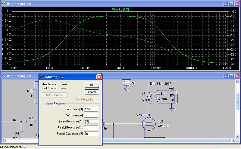

Looks like not well presented OPT for SIM program.
Check 5 Kohm in the primary. Like this:
But fellows, this is not a simulation, this is real. FWIW, the secondary of my OPT measures at about 23mH, so I figure about 14H on the primary.
For 4V RMS volts out, I'd need 100V RMS on the primary. Will see what I can do to get there.
I am afraid 14H is too low, but 5K is fine, you can get about 1.8W from 100 Hz approximately and up.
Eureka! I believe I have found my stupid mistake. What I thought were 5K:8 transformers turn out to be 8.5K:8 ohm. Well duh. That ought to do it. 😱

I saw in a simulation that the primary impedance of your OPT in real is very bad.
I like sims, but I also live and work in the real world. Did your simulation predict that I would use a OPT that has an 8.5K primary? Or did I have to tell you that first before the software figured it out? 😉
