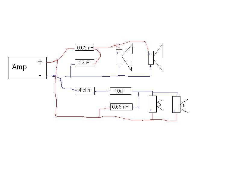

Actually it's PHT-407N I recommend. If I wrote "T", that's a mistake. The "N" version and the Monacor are almost identical (the Monacor one is just an OEM version of the p.audio one with slightly different parameter but still made by p.audio). The p.audio one have better parameters for this use.
No. You will need a real filter. It's described somewhere in this thread. (Or is it on a different site? I lose track sometimes). Maybe someone will jump in and tell me where I wrote it down.
You need a 2nd order Linkwitz-Riley high-pass at 2000Hz and a 2nd order Butterworth low-pass at 1400Hz. Which together with the actual frequency response of the drivers gives an acoustic 3rd/6th order Bessel filter at 1800Hz.
Remember to invert the tweeters and dampen them by 3dB with a series resistor.
:confused:
Here's a simple and fast drawing of how it should be connected. Please note that I made a mistake. The plus on the tweeters should be connected to minus on the amp, not the plus on the amp as I have drawn here.
Would this be the way to do it?:scratch:

If I was to add something about component choice on the x-over, it would be that the 22uF should really be 20uF realized by 2x 10uF in parallel. the 4 ohm resistor should be 3.8ohm standard value, and finally the coils (both) should be low resistance types (within a resonable price range) and it really doesn't matter much for the the nominal value as long as it's within about 5%, so anything from 0.60mH to 0.68mH will do as long as they are both the same.
So shopping is really easy as you only need this for stereo:
2x 3.8ohm resistor 5W minimum, ceramic will do
4x 0.65mH coils, low resistance
6x 10uF capacitors, MKP type
Coils are magnetically interdependent, so you they must be angled against eachother at 90 degrees and kept away from large magnetic influences like big magnets.
