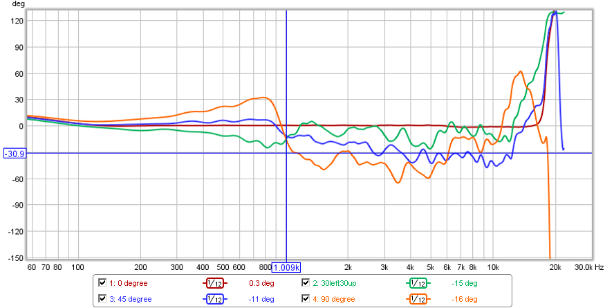

Elias: I think that most of your ideals could be achieved.
#1: agree, but isnt that impossible?
#2: agree. Quite possible.
#3: again I agree, and its quite possible to achieve.
#4: the band of freqencies you quote would suit judicious room treatment.
#5: i use transfer functions but never the modal variety 😉 Would getting #2, 3 and 4 be close enough to achieving #5?

#1 has already been achieved:
#2 is not a requirement;
#3 is effectively achieved by speaker system to demonstrate #1
#4 follows from #3 and good speaker placement
#5 for described speaker is exceptional
DSP based Pluto Clone has amazing imaging.
Regards
Andrew

Hey guys, are you missing the point ? 😉
We can engineer a loudspeaker fulfilling the requirements. But, have you given a thought what happens when two of those (ideal) speakers are placed at the corners of an equilateral triangle and the listener being positioned at the third corner ? The conspiracy is born which is marketed to the masses as stereo 🙄
Due to interaural cross talk at the listening position the timbre and pitch is screwed up !
Valid question to be asked: Is stereo triangle Hi-Fi ? 🙄
- Elias
