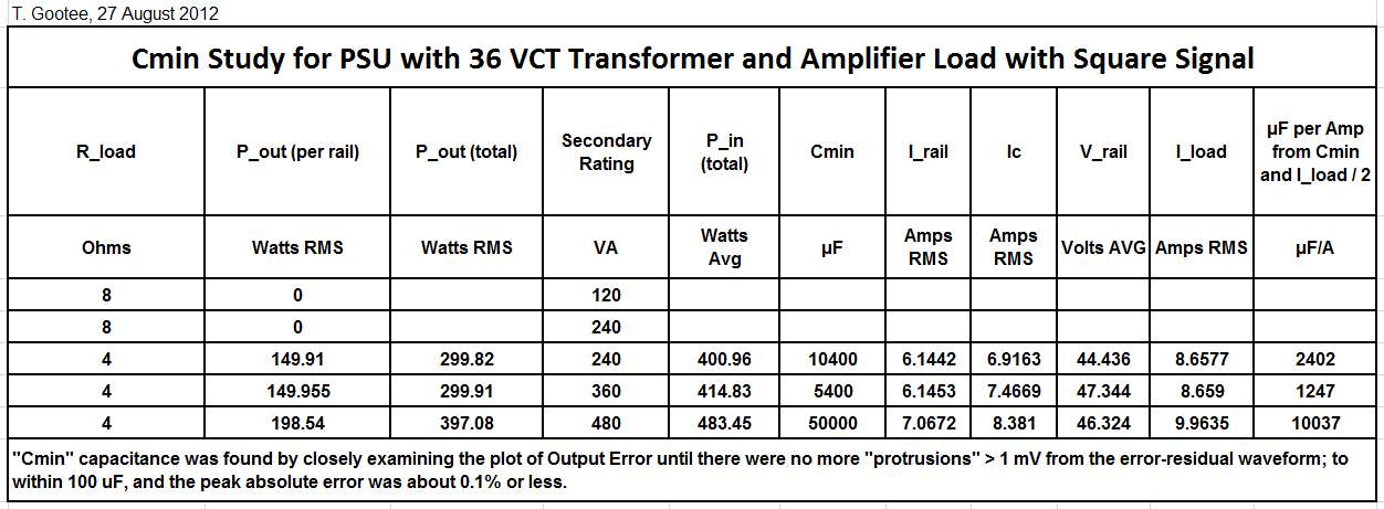

Attached are a few results for the Cmin reservoir capacitance, with square waves.
Not enough data for comparisons etc, yet, but:
The 360 VA-per-secondary case for 4 Ohms and 150 Watts looks reasonable.
It looks like 240 VA per secondary is either working hard to get 150 Watts into 4 Ohms, or, the 360VA secondaries finds it to be very easy.
And even 480 VA per secondary looks very close to not being enough for 200 Watts into 4 Ohms, with only a 36 Volt transformer output.
Tom

So something like a 600VA transformer would handle the ripple problem with half the capacitor value then?
So, DF, Terry, Fas, and other experts: Square-wave testing, with peak values equal to the peak sine values previously used, as in post 846, should be comparable to using a sine load current's or voltage's peak value instead of its RMS value, as the DC load current or voltage when calculating ripple and the needed reservoir capacitance using the standard approximate formulas, correct?
So it's like using double the power as a worst-case design margin, and throwing in huge fast transients, too.
Not sure what we're comparing to. But increasing the VA "can", sometimes, enable lowering the minimum capacitance while still not bashing the signal. But that only works well if you're in a comfortable operating area for the transformer output voltage.
You want enough headroom, with the transformer output voltage. Then you can use reasonable and predictable capacitance values, and a reasonable and predictable VA rating.
If I had cranked up the input voltage for the 200 Watt case, the minimum required capacitance would have dropped quickly. At some point, I might try to parameterize the secondary voltage and fix one or two of the other parameters and see what other types of plots might be useful or enlightening.
