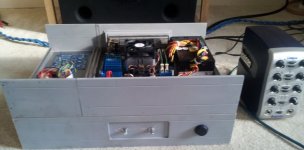

Here's the latest on the music server. Will probably shorten power cable to 2.5" HD. That is for system (OS) files only as an external USB box will hold all the media.
The base of the DAC chassis ended up being a separate unit. I might combine them later to avoid an external link. Just got the kit for this DAC yesterday and have not started to populate. It's the Dario Inserra favorite I mentioned earlier
Temporarilly using a Lexicon Omega on a 16' coax from my HT receiver to feed it and the integrated, Sounds fantastic!
I see a ventilation challenge coming forth that will probably dictate more separation than I had originally thought. I bought a pair of 70mm low noise fans but haven't figured out how I will use them yet.
The white card shows the size of the other DAC that's still being worked on. The transformer has dual voltages that will power either unit.
Please excuse the fuzzy pictures. Not on my best game this morning 🙂
...and yes, I'm getting tired of looking at dirty grey primer.

Bob, I envy your ability with cabinets... fantastic work! 😎
Just one suggestion: keep some space for and additional PS in the DAC one 😉
Thanks Dario - Having fun with both the cabinets and the electronics. I will check in on the DAC thread to get the latest and greatest trani. I bought the one shown to power the WM8740 unit several months ago but will upgrade to R-Core a bit later.
I was referring to a discrete shunt regulator for the analog part...
I bet you can guess which one I'm referring to... 😀

As seen in the attached pic, I'm almost done with the LDR. The long board w/ the relays is a Darwin from TPear. The blue board is a stepper motor controller. The tiny board atop the RegiReg is a Sure IR receiver. The first thing I want to power is a Alps powered 100K log pot.
This is the first time I built without a printed circuit. I hoped someone could comment on the pic of my solder joints but realize now the pic is too grainy. I will remove 499R and try to post a clearer pic.
