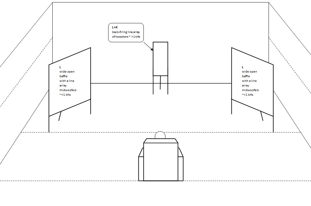

Later lateral reflections are all good, very early ones are not. Floyd does not make this distinction and to that I do disagree. There are many other consultants that I have talked to who agree with me on this point.
well, this is quite fundamental disagreement, with immense impact on practical speaker design principles, isn't it?
What facts ? What problem is the Beveridge placement solving ?
the problem bothering many people also here - that in a typically sized room we cannot push the delay of first reflections beyond the required 10 ms
You imply that it is eliminating early reflections, but you seem to ignore the reflection off the wall behind the speaker.
(Which conveniently doesn't have an arrow in your diagram, as if it somehow doesn't exist)
Unless the speaker is flush mounted inside the wall there will still be both diffraction from the cabinet edge and reflection from the wall behind it. Something which has already been pointed out to you in this thread.
the diagram is Beveridge's not mine
have You considered what is the direction of this reflection in case of such configuration?
I think You haven't therefore You say:
This is no different than pushing a conventionally placed speaker right up against the front-wall of the room and somehow expecting the front wall to no longer exhibit reflections.
please try to draw lines respecting the angle of incidence=angle of reflection principle
Granted that the directivity of the speaker will reduce the wall reflection somewhat at higher frequencies, but for proper function a Beveridge speaker would have to have extremely wide dispersion, thus greatly reducing this mitigating effect.
not really - it can just be toed towards the listener - no problem
plus - the speaker can be made wide enough to further lessen this alleged problem
You then introduce the serious problem that the listener is now about 70 degrees off axis from the speaker. This by necessity is going to mean an extremely wide dispersion design is required, which means narrow baffle and small drivers,
why narrow baffle? Beveridge aimed at just 2Pi or 180°, I believe it is not necessary, and that it was just by product in Beveridge speakers
why 70° off axis?? in original Beveridge more like 30° for typical equilateral stereo triangle, perhaps 45°, but 70°??? where did You find it?
anyway - we can just toe them towards the listener - no problem
which is going to provide heavy illumination of both the front wall and contralateral walls. What for ?
there are several strategies as to front wall - one is illustrated below, as to contralateral wall - ask Dr Geddes as He advocates this approach
reducing direct to reflected ratio.
You think it is bad? why? Let's assume that we have first 10 ms of clear RFZ

in the setup I propose below You can see wide baffle speakers with line arrays that help to lower the level of floor and ceiling reflections
let's assume for the moment that these are monopoles not OBs and let's forget about the center L+R tweeter array - let's assume that the L and R arrays are fullrange
let's assume also that they are closer to side walls - touching them and that they are as much toed as proves necessary
then try to draw the lines to see where early reflections go in such a setup
use Your imagination! sorry I can't draw new scheme now, maybe tomorrow 😀
