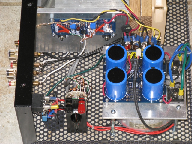

CeeVee's F5
Hi all,
Here are some pictures of my rendition of Papa's fantastic F5
I kept it as stock as possible for me so i would have a reference for things to come.
The initial sound is all i expected: fantastic...it's all been said in these pages.
pictures are of:
Initial low bias warm up....no Dc to speak of on output😀
Inside layout
First song with my Shanling drek as source ( new IV stage and russian coupling caps )

Hi Cee Vee,Hi all,
Congratulations!
your amp looks Fantastic!
I'm building a stock F5 too, is not finished but sounds great!
I have a thread about F5 in a Portuguese forum.
Regards
Carlos
The case is so F empty, we may witness the birth of a new breed.
Class A with no parts.
(but i worship tidy and symmetrical)

😀 true it looks pretty empty but sound is great.
I do have Cheff's UGS Power to build....and that really fills up the case.😎
may I say Fugly! ?
😀 Thanks ZM, may i say that after a lengthy burning in period the Shanling you helped me mod is now amazing with the new Russian caps for coupling.
Puts my Arcam CD73 to shame....and the Shigaclone is not as good either ( yet !).
It's easily the reference ...really fantastic through my UGS to show off the sound of F5...although it's early days the sound is already gorgeous.
But then again since there are no caps in signal path i don't expect much character change in the sound, just a bias fine adjust a few weeks down the road.
