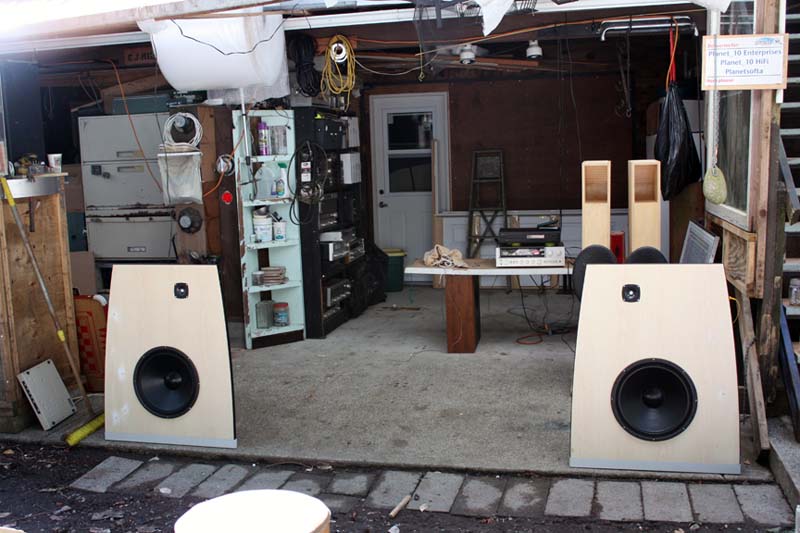

more here:
http://www.diyaudio.com/forums/club...ver-island-diyfest-2010-a-14.html#post2281225 and http://www.diyaudio.com/forums/club...ver-island-diyfest-2010-a-27.html#post2284026
Even with the cobbled together XO they are very satisfying.
dave
NICE !!
Doesn't it have too much bass in wide baffle ?
Doesn't seem to. Have only listened to them outside so far.
dave
I spent most of my time at the event listening to boxed speakers upstairs, but IIRC, the bass qualities of the OB varied significantly depending on the amp; e.g. most notably on Daniel's "transamp" which allows adjustment of output impedance while listening was a big improvement over the vintage Sansui receiver.
Using the passive high level XO pictured elsewhere, it's probably a safe bet that flea watt SE amps would not shine as well as they could with, say an FE126E or Alpair 7 in BLH like the Maeshowe.
dave
You know Dave, we should have taken them upstairs and tried them out, just to see what the room effects would have done. It was a busy weekend though and one can't think of everything. They are certainly promising, IMHO.
