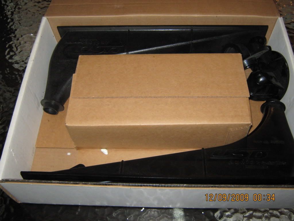

But with this USD Audio horn, the difference was hyoooooooge. The foam basically transformed it.
The QSC "curve" is close to perfect, and the waveguide is shallow. The USD horn has a ninety degree bend which creates a notch around 2khz, along with massive asymmetry. The USD is practically a worst-case scenario.
I ran the USD horns in my car for about two weeks, then threw them back on the shelf, because my own designs sounded superior. But with the foam, this rather unsophisticated horn is really quite amazing. The difference is night and day.
