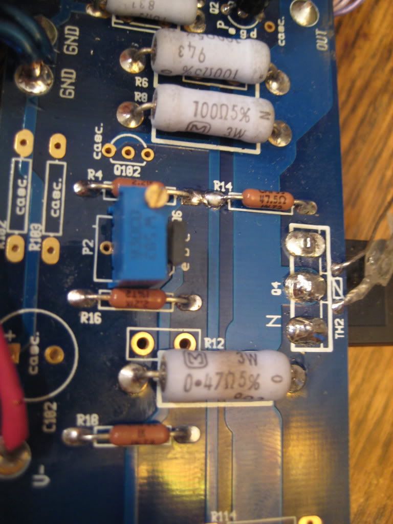

i set the pots to a minimum and after double checking all my connections, I fired up the amp and after maybe 5 seconds it started to smoke next to R12 (on Cviller's latest board-.47R) so i quickly shut it off. I was measuring DC Volts on the speaker outputs when it happened, and i measured 5mV. What am I doing wrong?
I measured 17VDC from my rectifier boards.
How did you measure that your pots were at a minimum? Could you post some pics of your setup?
thanks for the quick reply, I turned them clockwise all the way and got .2 ohms on all of them
but after spot checking the P2 on that channel I'm getting 60 ohms with the pot turned to minimum? maybe i didn't measure it right before... or maybe there's a bad solder joint on one of the legs?
I think the problems are the active devices around the pots. Try doing the measurements both ways with your meter probes. My best guess is that you have them turned the all the way in the wrong direction...
here is the affected area. ignore the red wire, as its the V- from V- confusing i know🙁
here is my setup if it helps any. Thanks

Christian is more than likely right. Pots set the wrong direction. Easy to do.
Replace the bad parts and try again. Careful to NOT burn the board removing old parts.........it get's costly, don't ask.

If you had a bulb serial connected to the mains, you wouldn't have burnt anything.
With some luck, nothing is burnt though, just a little toasted resistors.
wouldn't I get a reading closer to 1.5K? (2.2k parallel w/ 5k) When I turned P2 the other way (ccw) resistance was increasing.
Do you remember what your minimum resistance was from the pots?
Bob + Jack-You're right, I think I did jump the gun and not setup proper precautions with the power supply. Once I get things checking out, I'll rig a bulb in series so nothing further damages
