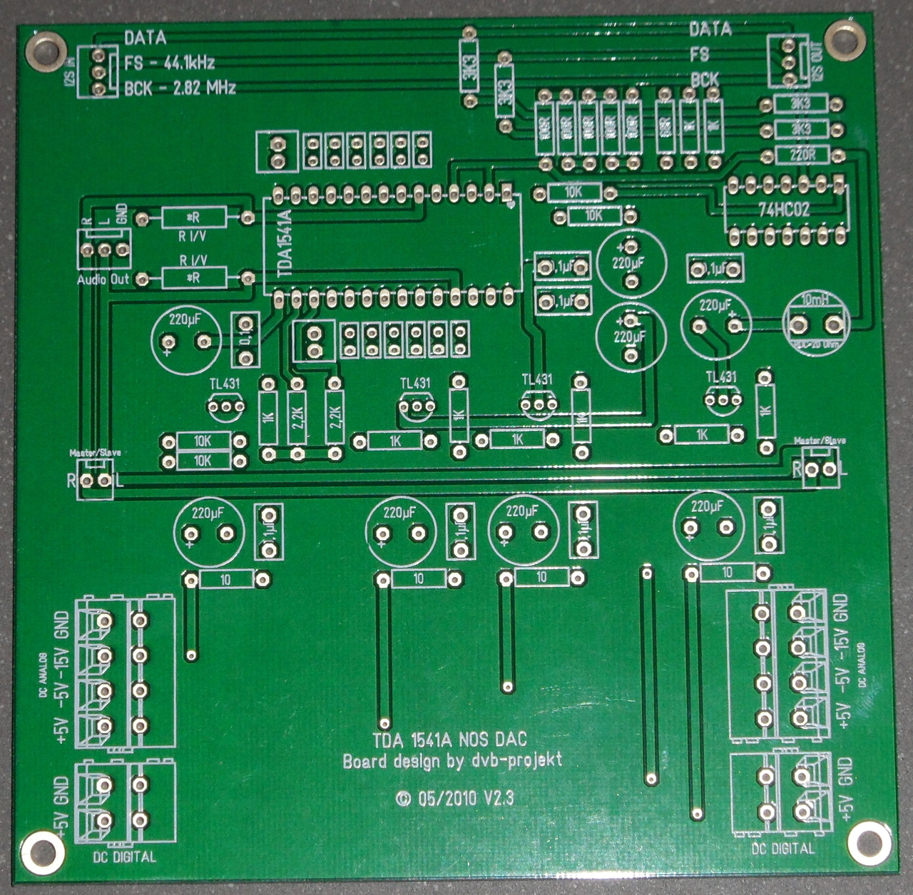

The TDA1541A DAC Module PCB

- separate TL431 Shunt regulators for each voltage line
- independent voltage rail for the DEM reclock circuit
- I2S attenuator circuit
- shortest possible position for decoupling caps
- separate ground line for decoupling caps
- Ground plane
- 2mm pcb
- Immersion Gold
- green soldermask on both side
- 35µm copper weight
- Board size 125mm x 125mm
