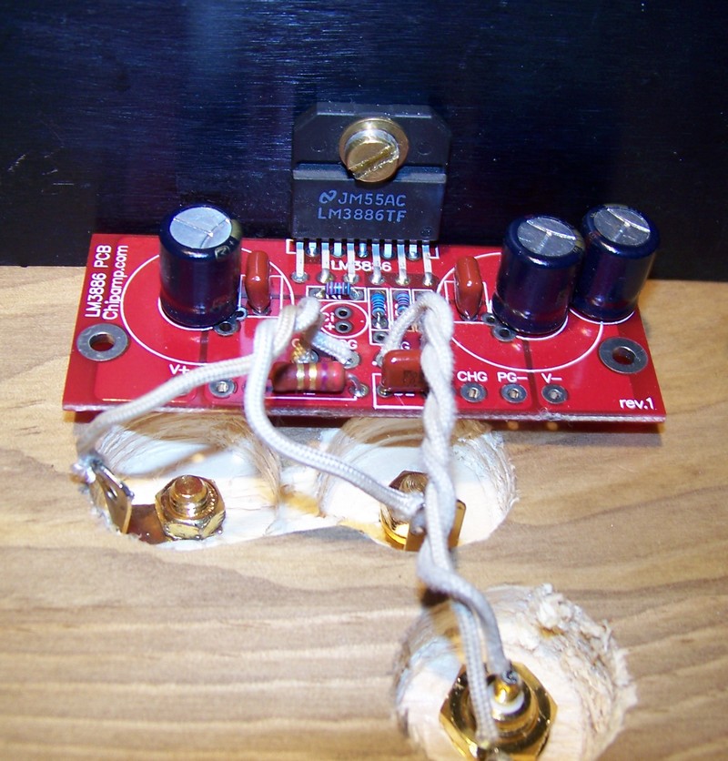

therefore in between I'll be posting progress on my LM3886 "gainclone"
I soldered the boards a long looong time ago. So no pictures. And I don't think anyone would want to see these boards soldered part by part. pcb's are boring in that way.
The build will be quick and dirty. But still something I could "live" with. Hopefully.

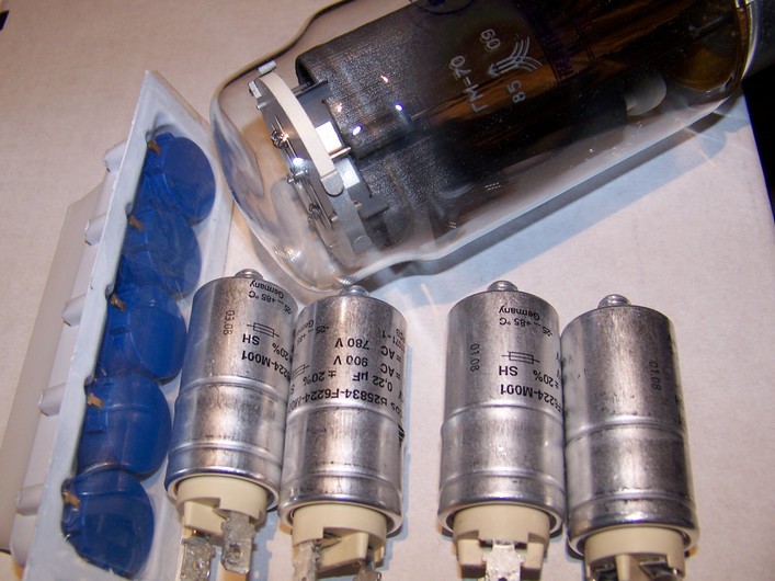

Look what the mailman/woman dropped at my casa.
A matched quartet of GM70's (Almost ashamed at how little I paid for them) GM70's are for a SE GM70 amp with MQ parafeed iron.
And the 500R trimpots and 0,22uF caps for the Baby Huey.

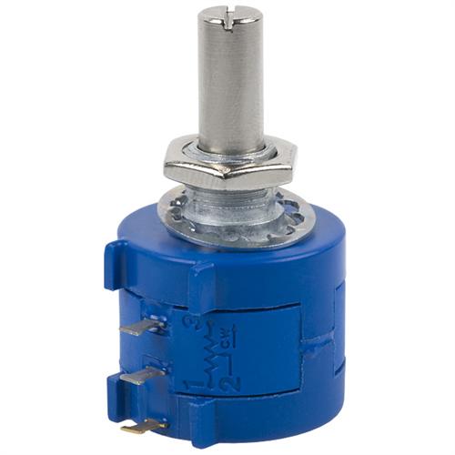

Ordered 500R pots for the driver stage.
Posted 18th November 2009 at 09:27 AM by Bas Horneman (Bas Horneman's diyAudio.com blog)
And while I was at it I saw some 0,22uF Epcos MKV from the same seller. The Epcos will do duty as coupling cap, as I've seen good reports (anecdotal) on them.

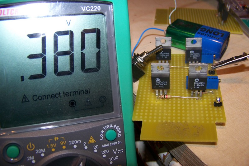

Output tubes's CCS's (bias blocks) completed.
Posted 15th November 2009 at 12:14 AM by Bas Horneman (Bas Horneman's diyAudio.com blog)
sans bypass cap.
Measure 380mV accross a 10R resistors. Therefore the CCS is set to 38mA.

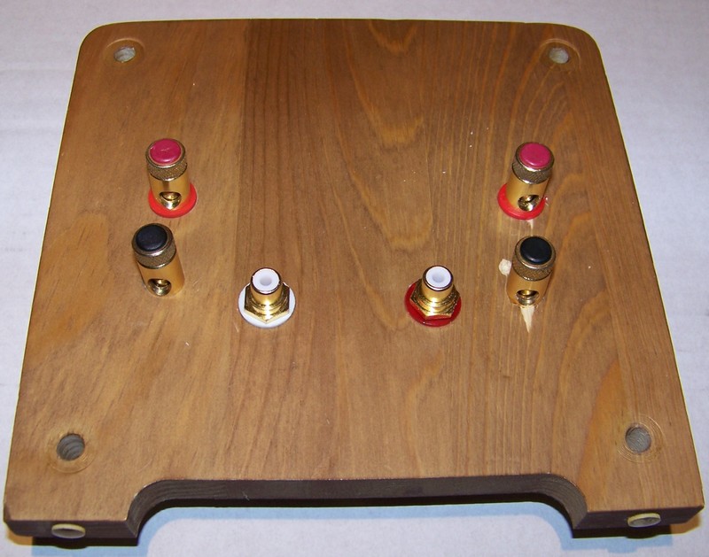

First holes have been drilled...
Posted 19th October 2009 at 08:07 PM by Bas Horneman (Bas Horneman's diyAudio.com blog)
Mock up pictures. The wooden "boxes" are from Ikea and will cover the output transformers. The single power transformer shown will be put under the chassis.
