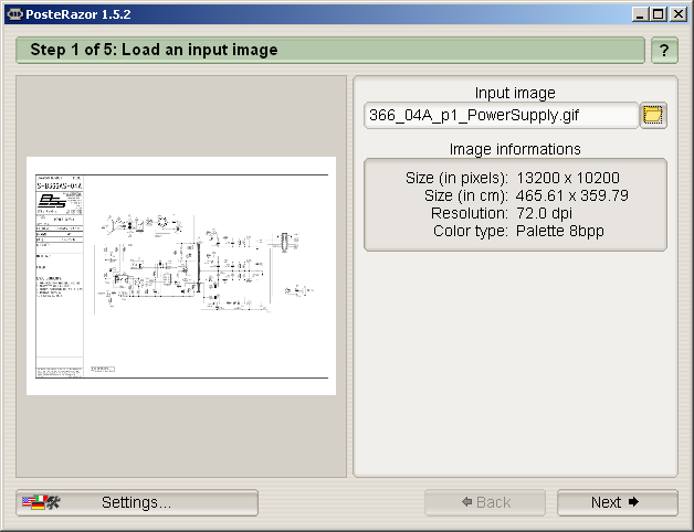

Step 1: Select source image (ie the GIF) - click the yellow folder icon
For some reason, GIF is now 72dpi and three feet wide, but this gets correctly scaled, in the end.

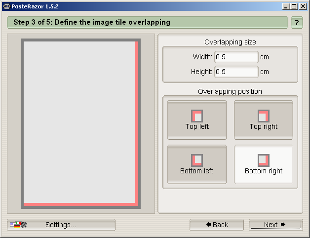

Step 3: Set overlap positions (defaults to Bottom Right), and overlap depth (default 5mm)
The red lines are where you'll be taping.

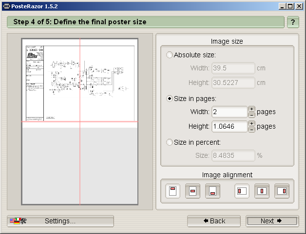

Step 4: Define poster size. For A3, this is 2 A4 sheets wide, when in portrait.
There are scaling options here, too - expermient as required. For my example, the original PDF page size was Letter, not A4, so the aspect ratio is slightly different. Although pages 3 and 4 will be created, I won't print them.

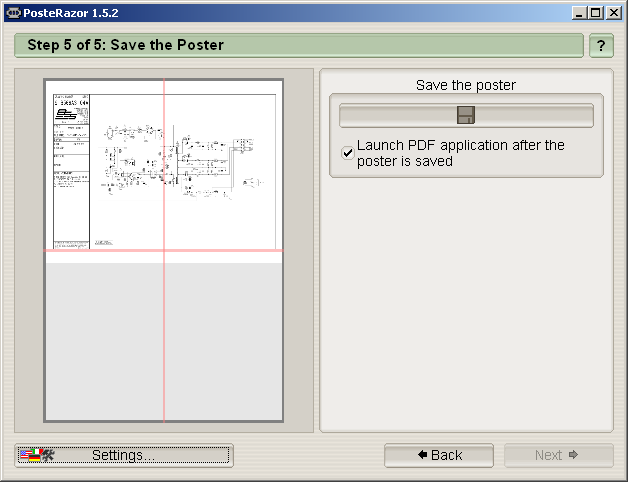

Step 5: Define export filename (export format is PDF)

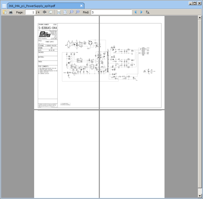

End result:
E. Print, slice off the physical margin from one sheet, and tape. Done!
