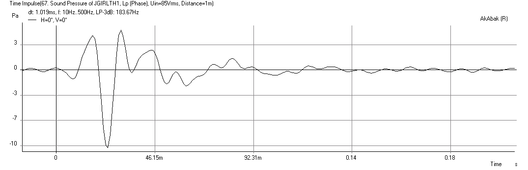

and the impulse
I'm not really sure what I'm looking at when it comes to impulse, that graph looks insane.

The average THD is at -40dB (1%) or below throughout the main range of use. The biggest thing is that THD does not rise up as you go lower in frequency like most BR subs, it is level and in fact drops a bit at the bottom of the design frequency corner of 30Hz. This means you can push this sub loud and it will still sound evenly clean throughout the range as THD will rise uniformly up with increasing excursion. Excellent. It should sound really clean and now that you have heard what clean low distortion bass sounds like, you won't be able to go back to non-TH subs. 🙂
for the impulse response, there is a setting that is a drop down button that selects between %FS - select the other one that gives a solid curve and not a histogram bar graph. Then zoom into -10ms to +100ms and you should see something like the IR predicted earlier:
So according to this sim, it says the main pulse is negative and is about 23ms delayed from the input signal. If this is true, you will get more impact by flipping the polarity (either positive and negative wires at the driver) or in miniDSP click the phase flip button on the output screen. That will give you a positive (compression) wave rather than a negative (rarefaction) wave. Subtle but probably a noticeable difference in bass chest thumping impact.

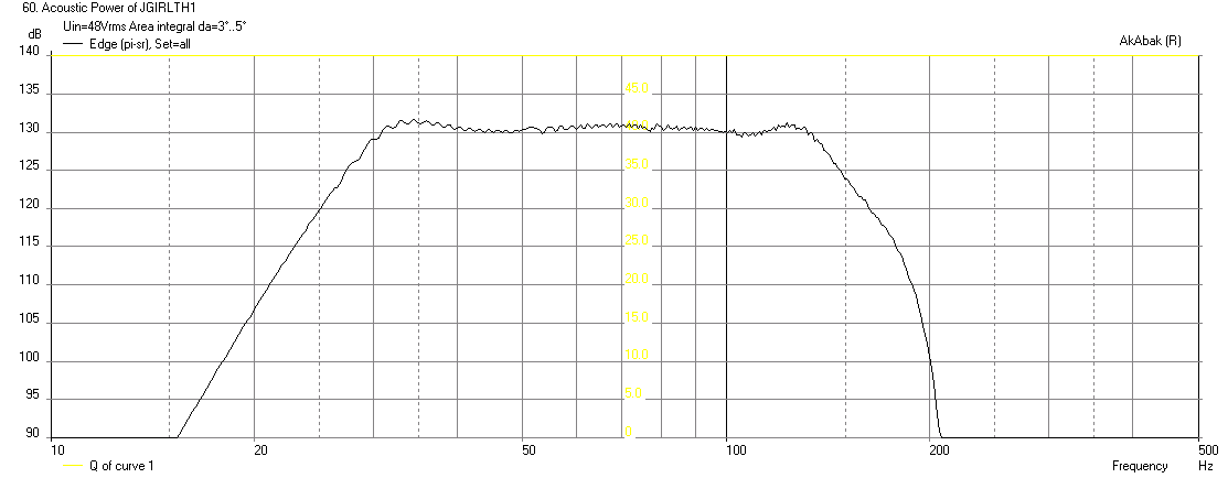

I gave it a try in AkAbak, the script is attached as a .txt file (this is not as good as xrk971's work, just more or less straight from Hornresp). This has the shortened L12 and two ducts, I also copied the high and low filters into it. The input voltage for the SPL curve was 52V. Just in case someone wants to try it.
It might also be interesting to see if one can use the extra volume resulting from shortening L12 as Helmholtz resonators.

Here is my script if you are interested (this has 4 of the tuning stubs turned on) but same L12 as original. Seems like the simple one does a pretty good job vs mine which incorporates all the turns.
