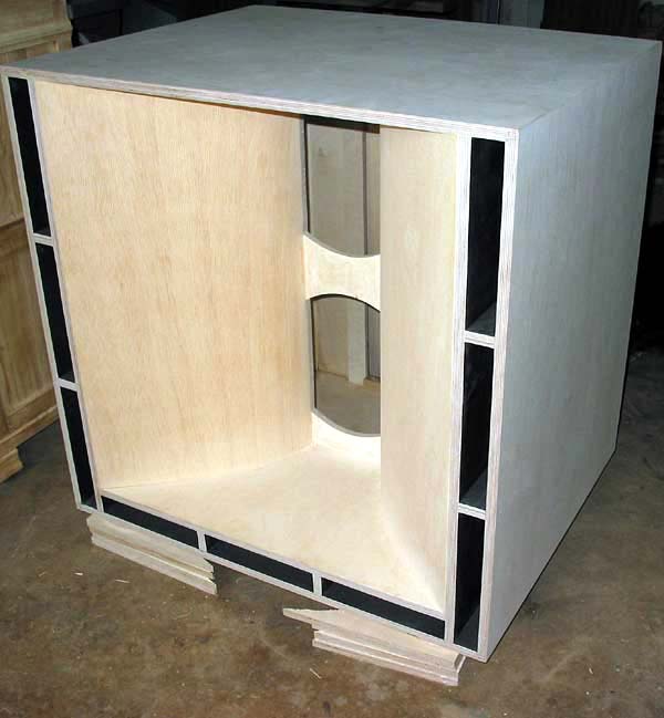

As to the ports, how about using ports as you might find them in a compound/Onken speaker(see attached)? I remember an old Frazier 8" back-loaded horn, that distributed the horn output all the way around the forward outside edge of the speaker.
This certainly can be done but may grow box and complexity of build. Personally, I am lazy and would do the qnty 8 x 2in dia x 5.5in long SCH 40 PVC ducts near the corners of the horn mouth and be done with it... 😀

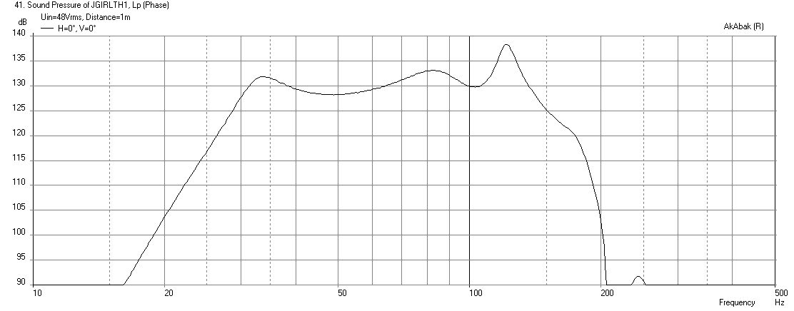

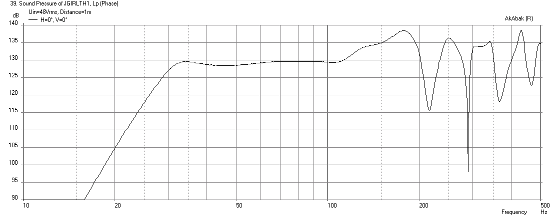

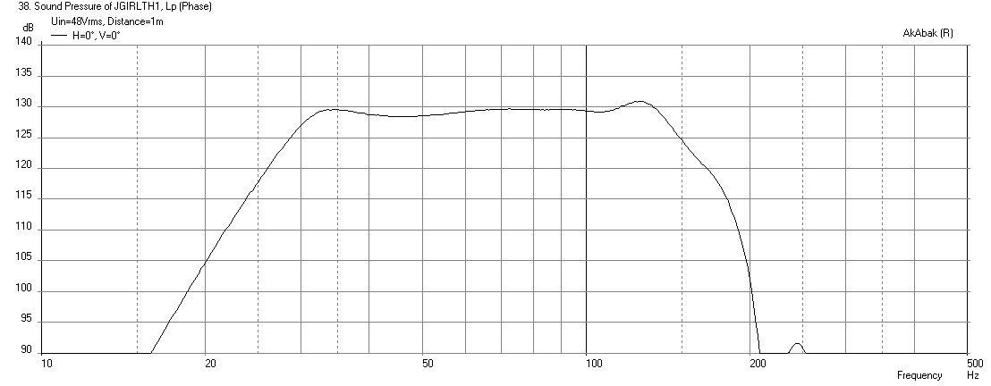

Here is your TH sim in its current state driven to xmax with no low pass filter:
Here is what your TH in its current state looks like with a -48dB/oct LPF at 130Hz applied:

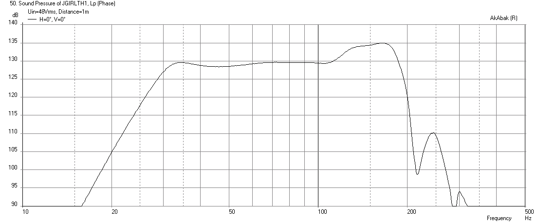

Here is what it looks like with the above stub tubes installed (no LPF) - note that in addition to the peaks at 122Hz and 176Hz being tamed, the sag at 50Hz is almost eliminated:
Here it is with the 130Hz LPF applied - pretty good upper extension and flatter response throughout - it becomes a better speaker, flatter response, can go up yo a higher XO point:

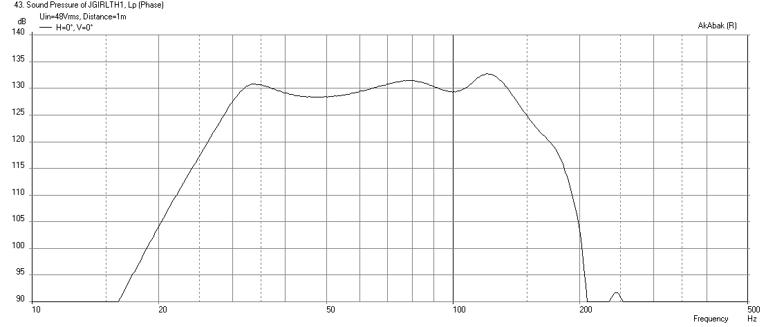

If you could only do one set of tubes, pick the 26.1in long ones and here is the response with LPF applied:
If you wanted to XO higher say at 170Hz, still doable, just need a -5dB high shelf applied in miniDSP vs a peak cut filter:
