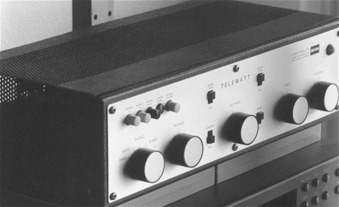

I have just built one for fun using the Single ended mullard circuit and a 5V4 as rectifier. It sounds pretty good, but definitely could do with a bit more grunt. Also the tubes get really hot, I am at about 8 or 9 watts dissipation tho.
Nice looking amp BTW, is it SE or Push-Pull?
In Push-Pull you could get a clean 10W or so from a pair.
The Japanese seem to love them, I guess its the whole miniturisation factor, they can be built on a very small chassis.
~h~
~h~
ShiFtY said:Nice looking amp BTW, is it SE or Push-Pull?
50EH5 stereo single ended pentode good for about 1.4 W. Follow the 5-Buck Amp link for the schematics and the story.
This is a single pentode spud amp.
dave
Heh...
I was actually referring to the origninal poster's amp...
Not that your spud amp is bad looking 😀
~h~
~h~
