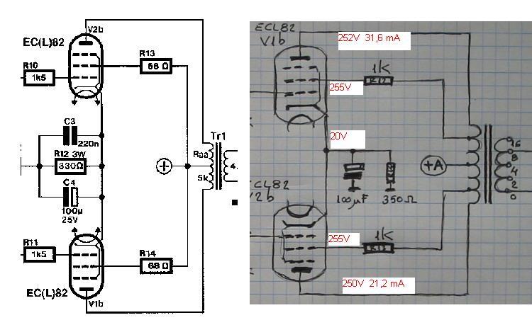

The schematic from Linde does not use the two intermediate windings of the primary (left drawing) but the original design of the amp did use it (right drawing). Now I have connected without using it, exactly as the book says. ¿Is there any difference about using it or not?

The one to the right is called ultra-linear.(Often 40% taps)
Not using the taps on the opt does not pose any problem whatsoever.

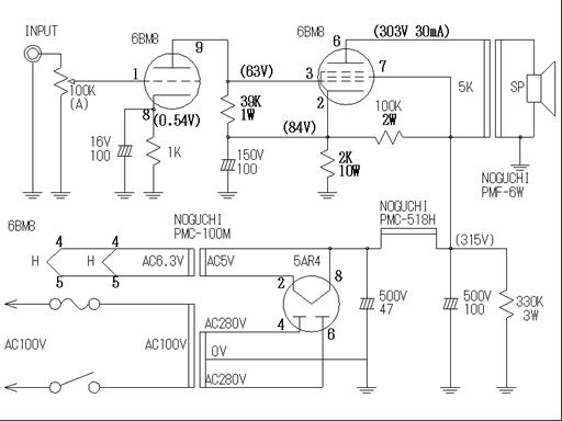

siu sin man tho said:hi,
this is the circuit that I choose. Had another people know that directly couple better or use RC couple better.
Any advise.
thanks
thomas
There are no better capacitor ...than no capacitor!
