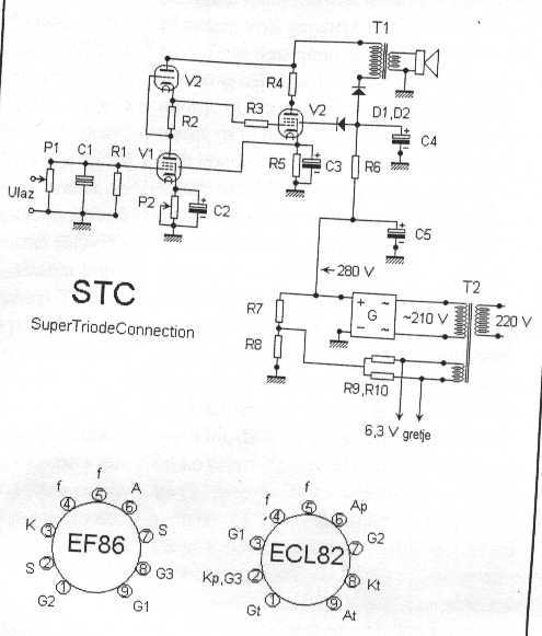

I'm building stereo amplifier and I need change for ECL82. I have at home some of ECC82, ECC83, ECC81, ECC85, EL84, EL86 and some others. So, with which of this tubes can I change ECL82?
Thanx!
Can you also look if the shematic is ok? I found only a mistake with potentiometer.

R1....... 1M
R2.......6k8
R3.......330
R4.......22
R5.......1k2 5W
R6......150E 2W
R7.......100K 2W
R8.......27K 2W
R9, R10....100
P1.....47K log
P2.....5k trimer
C1.....47pF
C2.....47uF/35V
C3.....100uF/100V
C4, C5....220uF/385V
V1...EF86
V2...ECL82 (6BM8)
D1,D2....1n4007
T1 .....for stereo: 200V-210V I=120mA, 6.3V I=2.5A, 50W
G.......diode bridge 385V 1.5A

Primoz,
The short answer is you cannot easily swap any of your tubes easily into this circuit in place of an ECL82 - your output pentodes have different characteristics that that of pentode stage of the ECL82 and you have no direct replacement for the EF86. Possibly the triode section of the ECL82 could be replaced by a triode section of one of your ECC83s without too many circuit alterations but there would be no point in doing so. As the circuit employs direct coupling throughout it is not an easy matter to swap a tube to one with different characteristics without circuit alterations - your power supply would also have to be reviewed if you use an EL84 for output because of it's heavier current requirements over an ECL82.
However, with the tubes you have (for example, ECC83 and EL84) you should be able to find schematics for good quality amps both on the web and by searching this forum.

Thanx for link!
I was interested in this amp because it is "something special" - Single Triode Connection. This mean that you have on output pentode, but it have voice of triode tube and other good things. More on this link
http://www.ne.jp/asahi/evo/amp/
I want to change the output tube, because ECL82 can give only 2W (and I don't have it) but EL84 can give 4.5W which will be enough. I have also output transformators for this tube. Problem is only triode in ECL82, because I don't know with which can I swap it. EF86 I'm going to buy. Yes, if I change the tubes there will be problem with changing the schematic...... If there is not chance with this amp, I'll make normal single ended with EL84

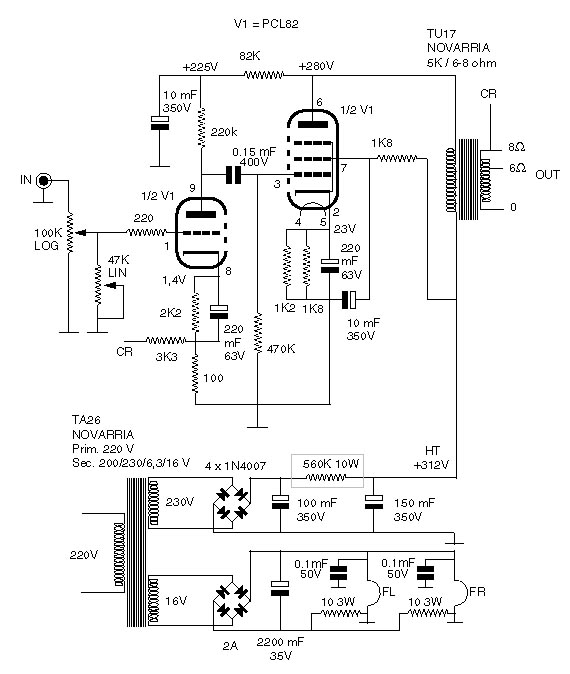

This is my little amp with the PCL82.
there are also a lot of amps with this tube on the schematics section of my site

Primoz said:Single Triode Connection
STC = Super Triode Connection.
Paul Cambie
also has some pages dedicated to this topology.

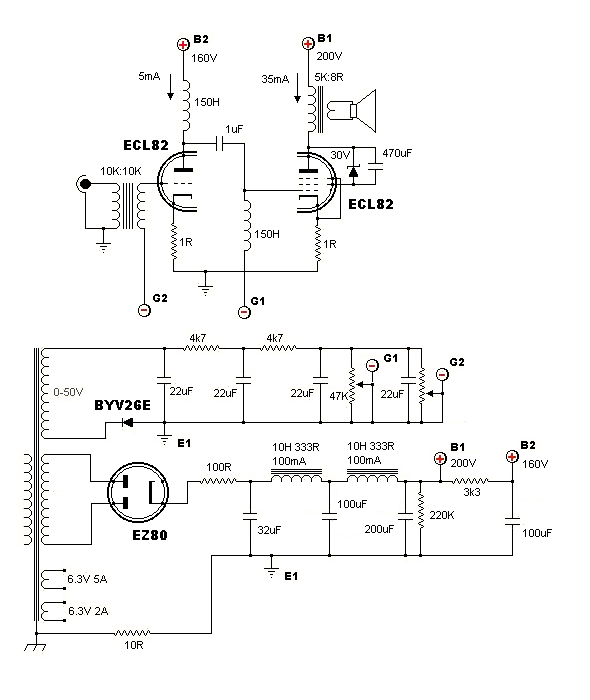

I have had (still have actually) a 6bm8 / ECL82 push pull amp for years. It was build with the transformers from an old Trio amplifier. It is the best sounding push pull amp I've ever made. Totaly build with dump materials for about 150 dutch guilders at the time.
This has been my reference for years. I've build many El84 pp, EL34 pp, 6V6 pp and two differenst kind of tube/mosfet hybride amps, but the damn ECL82 amp still beats them all. I really like this tube. It has a really good triode section and it has one of the best penthode's I've ever used and as a bonus, it's very cheap too.

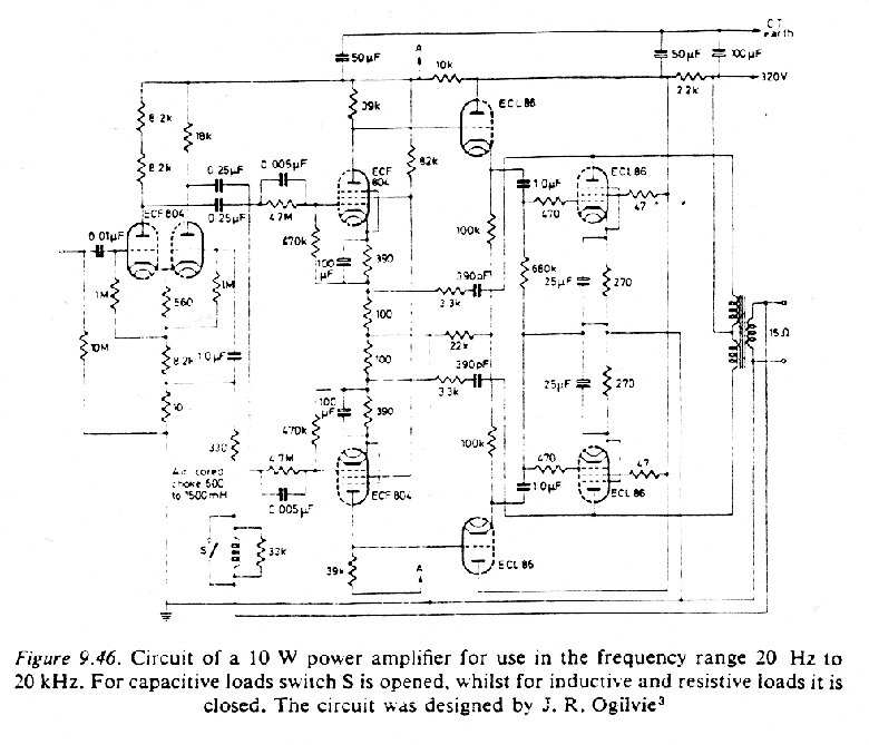

Hi EC8010,
Do you know what vintage that design is?
It looks like an solid state topology implemented with valves...
Three feedback loops? Or more?
I may well knock this up just to explore what is going on more....
Thanks for posting it!

Vintage?
Hello James,
sadly, I only have the one photo-copied page, origin unknown. However, the page also mentions the original Tobey and Dinsdale transistor amplifier. I agree, it has more of a semiconductor flavour. If you want to balance that, take a look at the design of the Quad 50, which is a Williamson implemented with transistors (right down to the output transformer)!
