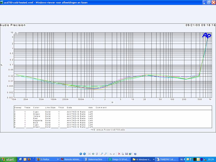

As promised hereby a measurement of the first two protos, who are at the moment working by one of my customers.
The power is really huge out of this new version! In a bridge setup we have something about 1.8kW in 4 ohm😀
Next week we receive a small pre-production batch, when we have done all our tests and everything is still ok, the product is ready for the first production batch. In about 6 weeks from now the amps must be on stock.
Jan-Peter

It's still a single ended amplifier, no plans yet for a bridged version. However you can bridge two UcD700 for a 1.5-1.8KW amplifier....
The design is much more complex as an UcD400, we use now a special design around the power fet's with schottky diodes, to avoid the problems of fast switching at higher voltages. The design is made on a 4-layer PCB.
Last week we have test the amplifier against our UcD400AD, and the sonic performance is again a step further...... 😉
