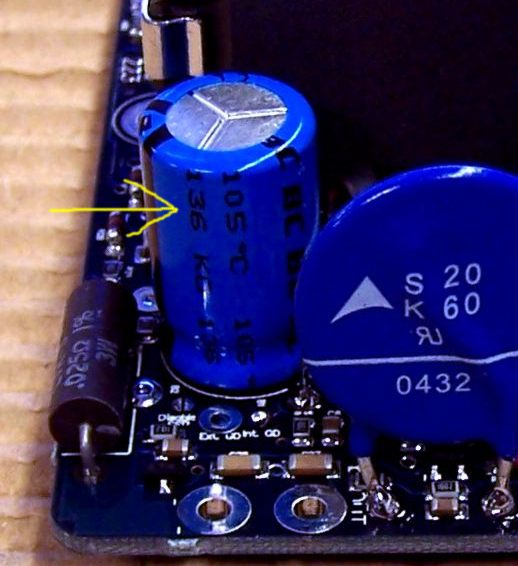

Hello,
Prices of the UcD700; I have to correct myself:smash:, in the protos we have used some standard 220uF / 100V capacitors. Because of the performance level of these new UcD amplifier, we only like to go for the best what is available. So we will implement the Vishay / BCC 135 (or the newer 136) Low Impedance 105oC capacitor. The price of these capacitors are much higher as the standard stuff, so……..;
The price of the UcD700ST will go to EUR 225.00 and with the AD upgrade to EUR 255.00. (ex. VAT)
I was in my first post about the prices a little bit too, sorry for this inconvenience....:cannotbe:
More technical info;
- input capacitors can be bypassed with a simple jumper.
- It’s now possible to remove the op amp buffer stage for upgrading to a dual single op amp (OPA637????)
- On the modulator we have add a DC offset potentiometer, to adjust the DC offset to <1mV. Interesting if you bypass the coupling capacitors…. ;)
- Now all 220uF / 100V capacitors Low Impedance Vishay / BCC135 (or the newer 136)
- there is a lot of space to change the standard 3x330nF output capacitor to other exotic types. Actually you can even place 5 capacitors in parallel (5x180 or 220nF instead of 3x330nF).
Jan-Peter
A very good choice!
Where did you come across this idea Jan-Peter? :D

Jan-Peter said:
Hello,
Prices of the UcD700; I have to correct myself:smash:, in the protos we have used some standard 220uF / 100V capacitors. Because of the performance level of these new UcD amplifier, we only like to go for the best what is available. So we will implement the Vishay / BCC 135 (or the newer 136) Low Impedance 105oC capacitor. The price of these capacitors are much higher as the standard stuff, so�E..;
Jan-Peter
I guess other low impedance caps could perform in that position as well? For example Panasonic FC? Actually was thinking of putting either BCC136 or Panasonic FC caps on my UcD400 modules, possibly 100V versions as these have slightly lower impedance. I want to take a look at the switching waveforms when caps are changed, anybody done that?
Best regards
Gertjan
