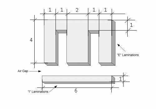

(See attached figure)
The code number is the lenght of the I part.
So, for the EI126, the I is 126mm long by 126/6=21mm wide, the tongue width is 126/3=42mm and so on.
The second number (if present) is the height of the stack. When absent, it is somewhat equal to the tongue width (square section).
i.e. "EI126-50" means a 42 wide by 50mm height stack.
Hope this helps.

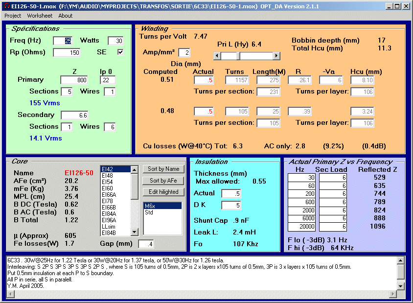

Cant cut and paste prog Yves,
BUT here is a rough idea of my TX project- using the calc-
Freq 25Hz, at 25W Rp 80 ohm, SE Pri Z 600 ohm Ip 190mA
Pri sections 4, wires 1 (122V RMS)
Secondary 8 ohm,
Sec sections 3, wires 3
14.1 RMS
Tx Iron, EI 120C Total 'B' 1.27 Tesla @ above. u=1083
Turns per volt = 7.43 Amps per sq mm = 2
Pri L = 10 H, Total H Cu = 13.3 Wire guage pri = .55 actual (.5 computed) Turns = 910 total, 228 per section.
Sec = .65 actual .61 computed Turns = 105 35 per section
Air gap = .2mm Shunt cap = 3.3nF, leakage = 1.4 mH, Fo = 74Khz
F lo = 1.1 Hz, F Hi = 76 Khz
My difficulty was allowing sufficient room for insulation between coils, hence only 3 secondary and 4 primary.
What do you think??
Thanks,
Alastair

Hi Alastair,
No direct cut and paste provision included, sorry !
You can however send me the "xyz.mox" file generated when you save project, but it can only be used by someone running the program.
To obtain a "Screen Copy", I use ALT+PrintScreen keys and then paste all as a new picture in any "PhotoTweaking" application (I use Paint Shop Pro)
I think you put the finger on a lack in the program !!
If I understand well, you planned a 3 sections secondary in order to have provision for 4 Ohms load using only 2 sections.
Looking at allowed turns per layer vs needed turns per section, it's obvious that 2 sections could be wound side by side, greatly improving the "filling factor", althought the program overlooked that optimisation.
Good you pointed that !
While I scratch my head for a clean correction, you can abuse the program by specifying a 4 Ohms secondary in 1 section, 5 wires, all in parallel.
This calls for 74 turns per each secondary layer, althought you will indeed wind it as 2x37 turns.
So you obtain 10 windings, 37 turns each that can be wired in serie/parallel combinaisons to match closely with 4 or 8 Ohms loads.
(Mmmh "closely", but what is the true load impedance accross the full frequency range ? )
Now, there is plenty of room to split the primary in 6 sections while still allowing for 0.5mm insulation.
And, cough cough ! the EI120C is bigger than the EI126-50 !!
Better at lo end, slightly poorer at hi ! Nothing for nothing.
Yves.

Frame size
I chose this size as it seems to be a popular size and should be available locally--But I wont find out till Friday as the guy I deal with is not in work till then.--Maybe he will have the smaller ones as well............
Trust me to find fault with something!--Sorry Ive exposed a glitch in the program.
(I was thinking of 'flying under the program' and adding two extra secondaries, of thinner wire, say .35 if I could get it to all fit, to help with the HF coupling, but I guess your way is better-)
Lots of things to be sorted yet, I need to find if I can definately get a certain size of Tx frame etc--I know I can get the wire in practically any guage, as a local motor rewinder has all sorts of sizes, in part-used reels, which they generally scrap, as theres not enough on them for a complete rewind!--Cant believe the waste in that company!--Great for me though, as I get it for free!

Cores and things............
Well, I went to my favourite supplier, who had some EI120 cores/lams bobbins etc.
The bobbins are marked 120 x 2" BUT the lams that fit correctly, appear to be EI114--
If looking at a single lam, The longest side, is 114.3 mm
The centre limb is 38mm wide,
each side limb is 19mm wide
The height of the gap for the bobbin is 57mm
The stack height is 51mm, Hence the 2" marking on the bobbin
I think the confusion has arisen because I have an Imperial core, sort-of equivelent of a EI120B (closest listed to mine in the Calc program, the AFe is quite close)--Tried inputting the data for my core to the calc, but it wont accept it when doing calculation, and I dont know what MPL in mm means, so cant enter this value!
I had a chat with my supplier, who has been in this trade for around 40 years, and described what I was up to--during the converstaion, I mentioned the word 'Inductance'--He looked square at me, and said--I dont 'Do' Inductance!--and being 'old fashoned, still works with Imperial sizes.--Even offered me a hand-winder, which I hope to collect Monday, proper counter fitted, big enough for any Tx I would ever need, but small enough to hide away when not in use. Cheap too!
