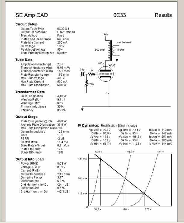

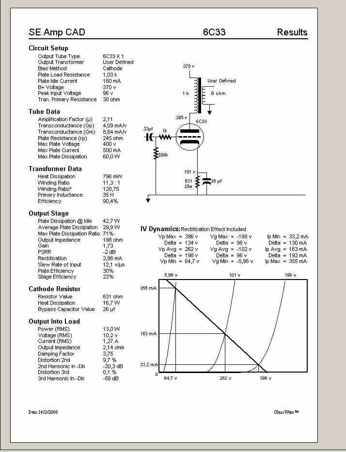

My secad software never seems to give an rp value for the 6c33 less than 250 ohms which results in otps primary impedance values around 800-1000ohms to maximize distortion/power trade off.
Also the 2nd harmonic distortion figures are quite high and never really much below 10% at full ouput unlike eg 300b which are consistently around 5%.
However the rp inconsistency vs usual practice of using the 6c33 with 600ohm otp is surprising .
Best results are around 270v on the plate and 150ma.

You would need to see the model in the software...to see how they are getting the rp.....
Based on the curve sheets...I get roughly 150 to 160 ohms AVERERAGE over one complete cycyle...
I think I know what is happening....
The plate resistance is not a "fixed" number with a tube....
It varies.... It is only fixxed at IDLE....and that is what I believe your software is using... at 270 at the plate...the rp is indeed closer to 250 ohms.... But if you look at where I choose my idle point...it is much lower...
WHen you figure for rp ...you need to take the AVERAGE rp over one sine-wave cycle....I typically use the full AC swing you would get at full power output....
I was able to finish a OPT design for this tube.... The core would be a EI-125 with 1.25"stack .... I achieved -3db points at 7 Hz and at 57kHz.... If anyone is interested let me know..
Chris

Since this thread picked up again I am attaching a screen shot of the results discussed previously.Mainly that with secad software at least it seems impossible to achieve 15w single ended outputs with 600 ohm otp and low B+/ high current.I am using around 260V on the tube and 160 ma w 1000 ohm otp which gives around 13-14W.
