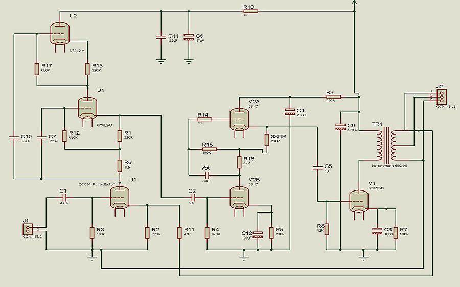

First testing-
Finally got my sig-gen back, and done some quick tests.
W/O Neg FB, 15Hz to 160KHz to -3dB
With Neg FB, 10Hz to 195 KHz to -3dB
This is at 20w into 8 Ohm non inductive WW resistor. The freq response is flat with no peaks at any points.
I have an issue with my driver stage at full O/P and lowest freq, that I need to sort out before I can give best performance figures. I'm able to get around 30W RMS before clipping at 1Khz.
Im unable to measture the THD, as i havent the needed equipment, but using the scope second channel superimposing the two sine waves, shows no visible differences.

Re: First testing-
Hey, really not bad.
Even a bit better than expected at hi ends, means computations are a bit pessimistics, unless you changed interleaving or insulation thickness.
Please, let me know so I could revise some formulaes (their are of the "cook book" type and somewhat empirics).
Can you run a test with squares at say, 100, 1000 and 10,000 Hz ?
At lo end, the limiting factor is the iron saturation, I'm not sure it could be significantly improved, unless having twice as much iron !
Usually, sines become distorded, tweaking the gap may be instructive (note I don't say constructive).
If you have a correct sound board in your PC, Google for Spectra Plus, or any other spectrum analyser.
Yves.

O/P Tx
For general info, here's how I wound the Tx's--(Ive finished all three now, and just need to sort out the PSU Tx.)
First layer, (First secondary) 85 turns, .56mm, just fits in on bobbin. This insulated first with layer of clear tape, of .05mm then a double layer of .11mm Mylar.
First section of Primary, with border between side of bobbin and start of coil of around 3mm, 61 turns by 4 layers, each insulated with single layer of clear tape then single layer.11 mylar 244 turns in this section, in .56mm.
(Borders are insulated with PTFE plumbing tape, and Anti-Track, Tx/Motor Varnish.)
Next, two layers of Mylar then second secondary, again 85 turns, then two layers Mylar, and one clear.
Second section of Primary, again 244 in four layers of 61 turns insulated by .11 single layer Mylar between layers, over single layer clear.
Then, third Secondary, insulated by two layers Mylar, of 85 turns.
Last Primary section built up as before, of 4 layers, at 61 turns each, with .11 Mylar single layer and clear, The last layer having an extra 5 turns equaling a total Primary of 737 turns.
Final Secondary of 85 Turns placed over last section of primary.
All sections of Primary series connected, and all Secondaries Parralleled.
Effectively, there are seven interleaves with the transformer, Three Pri, and 4 sec.
Testing was done by connecting Primary to 240v, all secondaries give 28 odd volts, but all are within .01V, All then attached in parallel, and one end earthed as was the laminations All transformers were left attached to 240v for an hour, No heating or earth leaks present.
Currently, using .2mm Air-gap, but Im going to try some experimenting to see the effects at low frequency. I currently have only standard laminations, as my supplier only had that size in standard--Hope to get some M6x soon, from a different supplier which should help the lower freq range power.
My sig-gen, only does sine and triangle waves, so cant check with square-waves, but will look at the suggested Software, if my Soundcard can cope, and check the distortion at rated O/P
Hope the info above is of help Yves, Thanks for your excellent help--There is no way I could have worked out the turns etc. Shows that the Calc works very nicely!

Schematic and other stuff....
The insulation is between .2 and .25 between Pri and Secondary sections. Each layer of Pri is insulated from the next by .15, made up of i layer clear tape and 1 layer Mylar.
Anti-Trak is some form of propriety varnish preparation a bit like real thick 'red-lead', I got some a while back when I was converting an Induction Motor into a generator and had to alter the windings for a different voltage. Motor Re-Winders use it to improve insulation of motor coils and to coat the insides of terminal boxes and the like Its Called, - 'UltiMeg 2000/372 Anti Tracking Varnish, Red' In spray-can like car paint--But smells nicer!Its made by, Advanced Electrical Varnishes, Birkenhead Merseyside, www.aev.co.uk
The attached schematic, is a work in progress, but is at the stage the amp is in real life--I need more +B at the driver, as Im getting a little distortion before full O/P of this stage--For normal listning levels, this is not apparent in the sound however. (Cant really notice it at high O/P either, but I know its there, and must fix it!) The O/P stage is very near at its max when the distortion form the driver becomes visible, and well over 25W RMS
Only real difference, is the O/P Tx shows a 4 ohm tap, which it doesn't in real life.
There is nothing original in this design, Ive blatently ripped off various stages from the Web, maybe with a few value changes to improve performance and to suit the valves Im using.....
Feel free to copy if you like............
Valve layout is, Top of twin-Mu stage, 6/30L2, gen purpose double triode--6DJ8 works just as well, but I have some nice NOS 6/30L2's and only well used Mullard 6DJ8's both have similar figures............
Bottom of first Mu stage, is ECC91 parrallel strapped double triode. Nice NOS Mullard ones.
Driver, is the venerable 6SN7 or at least its Russian analog...........
O/P is ubiquitous 6C33c-b--The rest you know........
To my 1961 ears, it sounds very nice, but perfection is in the ear of the beholder...........
Add 15 for mine
Good looking schemo, but so many toobs !
