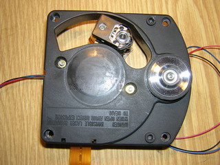

Your philips cd850 uses a CDM-4/19 mechanism. Apart from that, it have nothing to do with the gear. Various models use the same CDM, but different tray loading mechanisms and different gears.
Also, the rubber belt isn't going to last forever. You might as well order one of these too while you have their attention.
4822 358 10115
The CDM-4 alone looks like this and is used in various models and qualitys of drives.

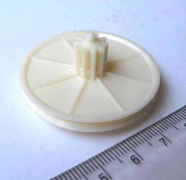

Hi ,
I found this in my Rotel RCD855 player. The Philips part broke and I bought one from Singapore Philips service a few years ago.
The Rotel one is made of different plastic ( white) and seems to last forever.
I also found this in the local market recently for a really silly price.
Want me to send you some by air mail ? If it doesn't work well you can throw it away , it's that cheap ! I'll check again to see if dimensions are identical.

CDM4 and CDM9 gears are not the same!
Be careful, there two different gear for CDM4.
One type for standalone loader.
Other for integrated loader like your CD850.
