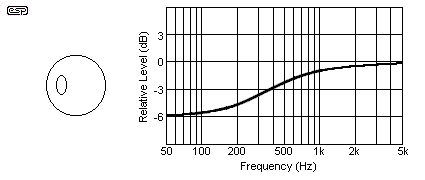

The original work on this used a relatively small driver in
a relatively large sphere which gives a smooth transition.
🙂 sreten.
The diagram is for a 300mm sphere, ~ 50mm driver. (Olson)
Scaling this should get you very near actual step overall
IMO, but there will be some ripples due to the cylindrical
type edge around the driver, and for a larger driver its
own dispersion / response comes into play above say 2kHz.

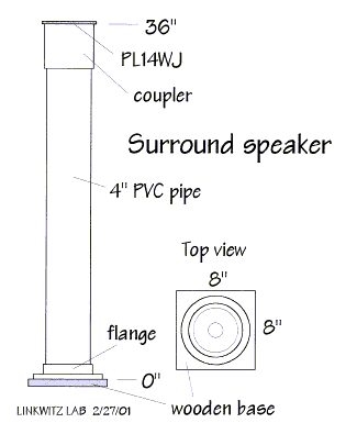

Vikash:
Linkwitz mounts 4" drivers in 4" pvc pipes firing upwards for ambience. What are the downsides to this approach? Are you saying NOT to do this?
you're actually closer to a driver mounted at the end of a cylinder which is at the other end of the scale for a smooth baffle diffraction rolloff
Well maybe sreten has olson's response graph for a driver in a cylinder as well, but basically the wave falls off from the driver edges at the same time - which is at the opposite end of the scale from the sphere which allows gradual roll off and thus a smooth transition radiating from 2pi into 4pi. The effect of mounting into a cylinder is the worst transition step with a very bumpy responce IIRC.
I have no idea what LR is doing.

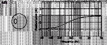

edit: you can see the baffle step effects for different baffls here
Then the wave radiates into full space when it reaches the driver edge, and therefore the diameter of the driver dictates where the baffle step begins I would assume.
