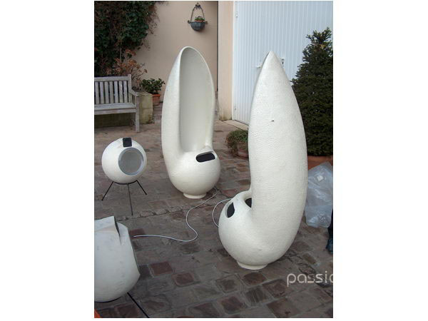

Back thru the middle of the last century there were quite a few round plaster speakers made in France under the brand name "Elipson". I heard a few - not bad at all. Some models used very good drivers.The famous rabbit ear model was a real crazy looking thing.
They were made of a sort of plaster called "Staff". I believe it is plaster with fiber mixed in. So your idea of the paster bandages seems to be on the right track.
See the Elipsons below.

That French site with the bunny ears made from staff has spheres on it produced by the late J Leon who was the driving force in the Elipson Loudspeaker company. I have never seen so many variation of spherical loudspeakers in one place before.
This man was into Spheres in a BIG way !

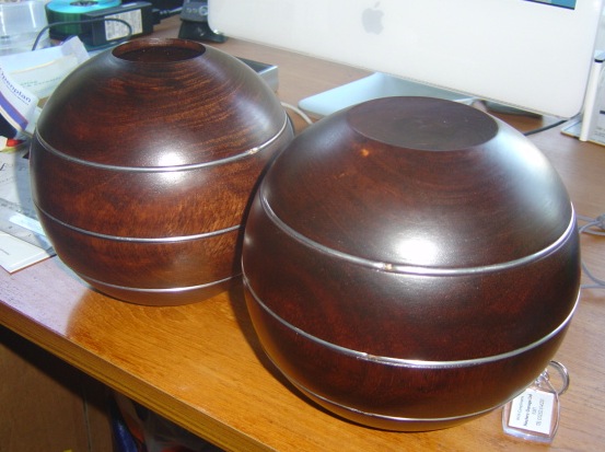

well I picked up these at my local mini mart . These wooden spheres are approx 180mm diameter (external). Hole size is 65mm, which is too small for the 76mm needed for the tangbands.
I was actually thinking it would be easier to drill a new 76mm hole in through the base and either seal the original mouth with a piece of wood with binding posts, or maybe leave it open (a spherical reflex ? any views). Internal volume I estimate to be 1.76 Litres (4/3 Pi r cubed) My plan is to experiment with these , possibe as a pair of PC speakers powered from a T-amp. The spheres were £20 the pair which is I guess 30 Euros/dollars

I thought that too, the wire loop inserts are a little loose and may need a little glueing down. Not sure what kind of wood, I guess they come from Asia somewhere.
W3-871's are what I want to use. I have the drivers already and may over time try various cabinets including needles, but the spheres caught my attention. These TB's are also shielded so suitabble to be placed near TV/PC screen. Hopefully get a 3" hole cutter today. The right hand one is inverted so you can see that the flat base, which is just over 76mm (3") diameter. So I think I'll cut a new hole through there rather than mess with the existing opening.

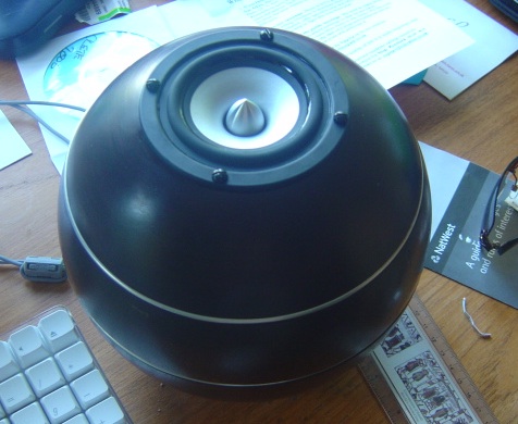

So I found a suitable speaker terminal plate on ebay but stupidly I only got one, and now they have run out. It's a shame as the insert hole was the right size to use the original vase mouth . I drilled a new 3" hole in the base for the driver.
have not listened yet as I was hoping to locate another 2.5" insert plate that matches this one.
An interesting problem I noticed is the center of gravity. The tangband magnet with shielding is pretty heavy. This is just behind the driver, so the whole thing is front heavy. If you place the ball on a surface or in a circular mount it tends to roll forward/down. I will give this some thought. Maybe a simply wooden ring to sit it on the desktop and the cables will stop it rolling

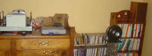

well I got both sphere complete. No notch filters yet, but I decided to setup my second system where my usual system goes. so the balls sit on top of where my LS3/5as normally go. Amp is a T_amp and front end is a PSone
The sound is good. It does shout a bit at times (hence the notch) and there is little bass BUT it images as well as anything I have heard, and on some tracks the bass is surprising.
the metal hoops , a feature of these vases , are starting to rattle so I think I will apply some more wood glue.
