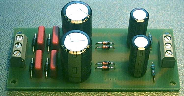

This the PSU.
I use here 4x 11DQ10 Schottky diodes. MKP Wima across them and Panasonic FC caps. The ICs aren´t on the PCB yet.

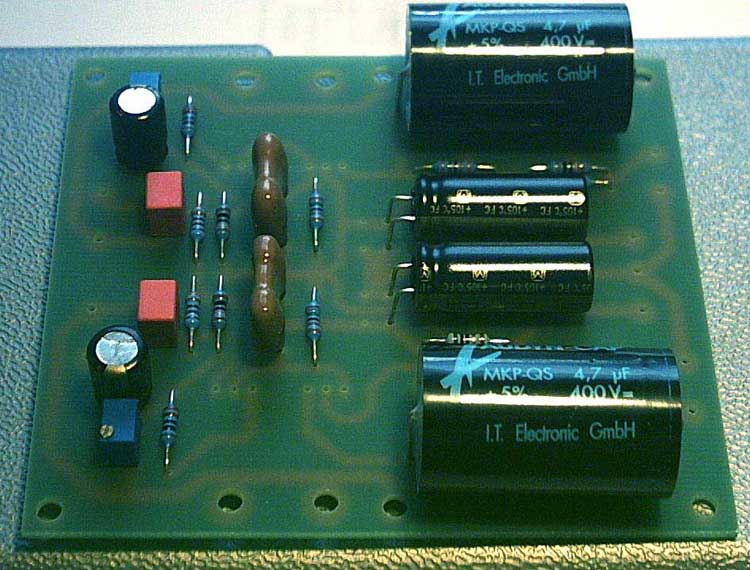

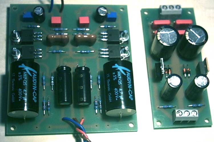

This is the actual stage with two stages on one PCB. You could actually use it for balanced signal also.
I use the signals singel ended so use only one board.
The Mosfets are missing from the PCB but all other parts are on it.
Silver Mica CAPs for the filter part. Audyn 4,7uF in series with the output. Welwyn 1% low noise resistors. Panasonic FC electrolytics.

The Mosfets are missing because I don´t have the heatsinks yet. Or maybe I will use them without heatsinks. I don´t know yet.
The I/O stage is exactly the same from Nelson Pass´s D1 DAC.
So it´s finished at last. I could only test one channel for the moment because I have to make some changes on the DAC board.
I took the opamps off but I have to desolder a few resistors and capacitors or they will effect the signal.
Setting the DC voltage of the input isn´t so easy and stable as I thought but it stays in the range +/- 10 mV.
Does anybody know how much this should be max. ?
It doesn´t effect the sound though which I can say is super super clear.
I also made a few corrections on the PSU after burning 2 diodes in the bridge. That´s what happens when you try to test it 2:00 clock at night. :whazzat:
The inputs are at the top of the picture and you can see in the top corners the 2 small trimmers. With these you set DC offset at the input to 0V.
I use the PCM 1704 which has a current output like many DACs and the voltage there must be at 0 Volts. :att'n:
The outputs are at the bottom where the 2 Audyn Caps are.
