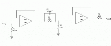

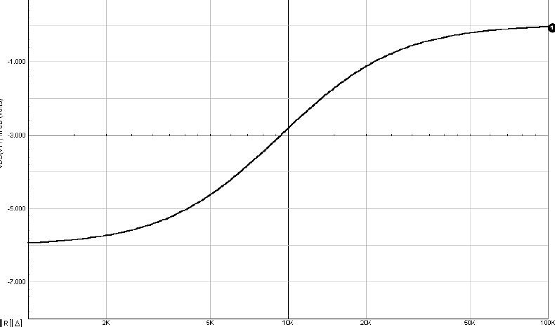

High Frequency Shelf EQ
The op amps could be replaced by followers.
For a tube circuit you may want to multiply the resistors values by 10 and the divide the capacitor value by 10. You just need to drive it with a much lower impedance than the network's and follow it with a much higher impedance. The circuit has 6db of loss at the frequency range much lower than 10KHz and moves to unity gain at very high freqencies.

The circuit below sorts out the high end roll of of my horn. About the different response in 700<f<5500 and 5500<f<10000: is it possible to make something like a band pass for the lower intervall and parallel it with a padded down high pass 5,5kHz ? Behind this 5,5kHz highpass the correction circuit for the roll of?
I don´t have spice software, but i see it would be good to learn using it.

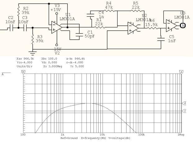

one idea (simulation only)
Regards
I have no idea.....
What you have posted is a bandpass filter.
It does not meet the requirements of either the high pass or low pass fillters, which are actually two filters. Back to the drawing board...........

and
"The circuit below sorts out the high end roll of of my horn. About the different response in 700<f<5500 and 5500<f<10000: is it possible to make something like a band pass for the lower intervall and parallel it with a padded down high pass 5,5kHz ? Behind this 5,5kHz highpass the correction circuit for the roll of?"
My circuit is good approximation of desired fr.response in TIll's first post, nothing else. IMO
Fred Dieckmann said:What you have posted is a bandpass filter.

"a band pass for the lower intervall (700<f<5500) "
"parallel it with a padded down high pass 5,5kHz ? Behind this 5.5kHz highpass the correction circuit for the roll of?"
For the low interval I think you want a high pass at 700Hz followed by a low pass at 5500Hz.
The upper range is a high pass at 5.5KHz followed by EQ for a boost in amplitude for frequencies over 10KHz.
I posted only the shelf EQ. The point off the thread was to investigate adjustable Q and frequency crossovers. I am not going to design specific crossovers for people as it would be immpossible without knowing the driver responses. I can not tell what your bandpass does with no units for the amplitude (y axis) unless I simulated it.
