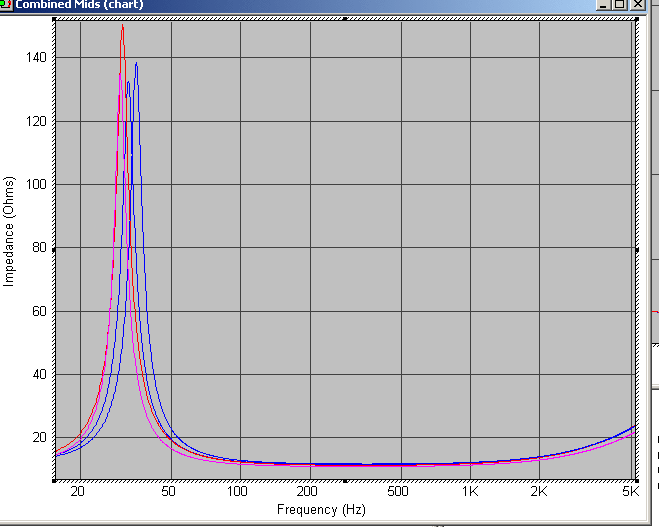

A couple of concerns. My measurements show Re = 10.9 (versus 5.7 on SPH-175 datasheet) and SW impedeance plot shows impedence = 150R at fs (versus ~93 on SPH-175 datasheet)
Where would you put your money? Almost certainly at a different revision driver right (my TDL's are at least 7 years old)? Or perhaps it was a modified driver just for TDL? Or maybe its my SW setup...but testing resistors is accurate.
I would go with your SW measurements. I suspect that you are correct in your assumption that the driver may well have been "updated" since. 😉
meaning believe them, or the fault is in my set up?I would go with your SW measurements
I ran some quick tests: my jig v2 and SW exactly matched my DMM readings for every resistor measurement. (I went up to 2K7R)
Is it possible for t/s parameters to change over years through underpowering, overpowering etc?
I'll test the other three drivers to see if I get consistent results.
Well, it looks a little more than I would expect for new drivers, but for well used 7 year old ones I am not surprised. Just think of them as properly run in! 😉
The differences are likely due to manufacturing tolerances being exagerated by time and positioning. For instance, was one driver more in the sunlight than any others, or maybe one speaker was nearest to a radiator or an indoor plant, leading to slightly different levels of humidity. All will have a slight effect over time.
I would suggest that if you use them, you pair them up so the lumped parameters even out.

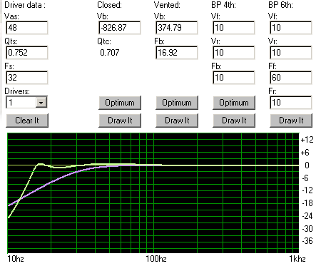

HELP! I just tried modelling the drivers using the t/s params derived using SW (haven't done the VAS yet - using current Moncaor SPH-175 VAS = 48l, xmax=2mm)
fs=32
re=10.9
qms=9.11
qes=0.82
sd=137cm
le=0.44
Unibox Standard Designs:
Sealed
Vb=1760.8l
fb=32.86Hz
f3=32.87Hz
Ported
Vb=750.6l
Fb=16.92Hz
F3=12.95Hz
LOL. Can anyone shed some light on the suspect qms and qes values?

Hmm, just used the online version of winisd with your numbers for a quick check, and it comes out with the following recommended sizes.
Ported - Volume 97l, F3 at 25Hz, Fb 26Hz
Sealed - Volume 48l, F3 at about 45Hz
Both of these seem reasonable, within isd's usual limitations on tuning, and from what I remember of the drivers. Maybe you have found a flaw in the Unibox curve fitting routines. I would suggest trying the above volumes in Unibox to see how they work out.
Eek, calculated Qts wrong!!🙄
Doing it properly by hand it comes out as 0.747, near enough your result. Hmm, I will have to think about this some more...
How closely do your measured results with SW come to the published data on the Monacor?
Way out. But ignoring even the SW measurements, the Re=10.9 (published = 5.7) which could mean it's a different driver.
If I change the Qms to something more sane, everything seems to look better. I've measured each driver a number of times, trying different ways of supporting them just to rule that out, but the measurements are relatively consistent.
SW measures my sub closer to its published specs (after 4 years use), so it's not an obvious SW setup error...
The Re thing suggests a 16 ohm driver, does this agree with your curves on SW?
The high Qms is strange, but I once measured an Audax 5" driver that had a Qms of about 12, but the Qes was much lower, at about 0.3.
I wish I could remember the exact designation of the Monacor driver, perhaps it had significant differences to the current model. Maybe even it was a driver modded by TDL, that they then released in their general range, but is now discontinued.
I would check the Vas as a priority.
I've had a thought. I questioned the high impedence at fs and then forgot about it. Now i don't know how the qms is calculated, but perhaps this is related somehow. I guess it's feasible that a bad SW setup could result in increasing error of impedance measurement as it gets higher, thus being realistic for my sub (~35R at Fs) but not so for the Monacor (~130R at Fs).
Yes.The Re thing suggests a 16 ohm driver, does this agree with your curves on SW?
I questioned it as I don't see Monacor offering multiple impedances as an option for their drivers.
